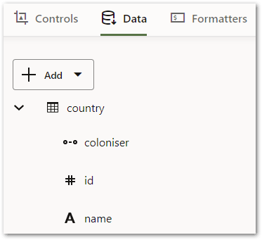

Global input data defined in a flow scheme project in Intelligent Advisor Hub

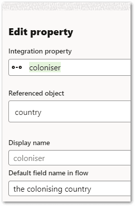

Where the coloniser record reference has the following properties:
The property settings for the country object in a flow scheme in Intelligent Advisor Hub
The IAFlowSession.globalInputDataDefinition JSON scheme will look like:

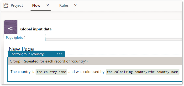

with a sample flow of:
A page in a flow in Intelligent Advisor Hub showing country names in a label
results in:
A page in a flow application showing the country name and coloniser country

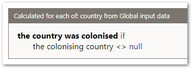

Also note that the objects defined in the global input schema can also have rules written against them.
For example, if we only want to show the colonised countries we could create a rule like:
A rule in a flow project used to determine if the country was colonised

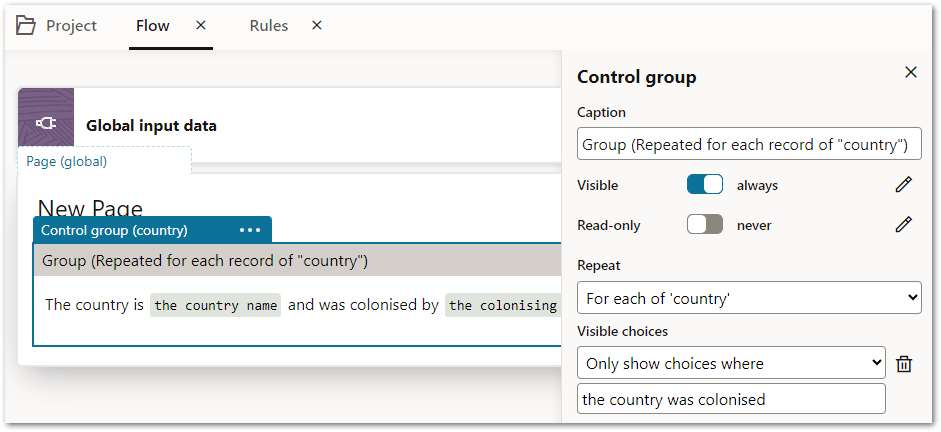

and then include that rule in the properties for the control group:
A rule used to control the visibility of choices for an object in a control group in a flow project
results in:
A page in a flow application showing only countries that have been colonised
