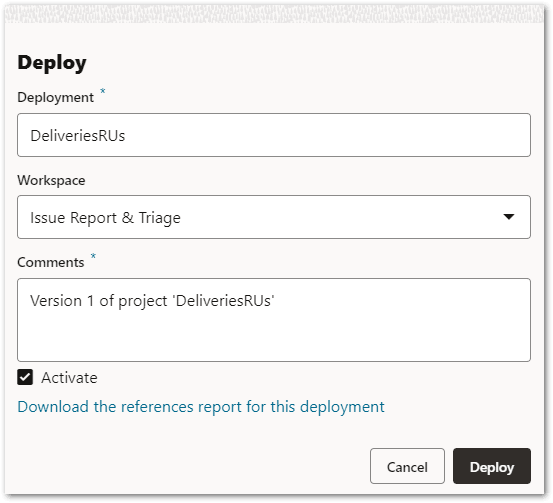

  5. In the Deploy dialog:
    • in the Deployment field, enter a name for the deployment. Note that the deployment name cannot contain any of the following characters: \ / : * ? " < > | ; % + @
    • in the Workspace drop-down, select the workspace for the deployment (you can deploy to any workspace for which the user has the Manager role)
    • in the Comments field, enter any notes about the deployment
    • select the Activate check box if you would like to activate the deployment as well. The Activate option is not available for Authors.
    • Click the Download the references report for this deployment link to generate a report of which projects and deployments are using the decision service
    The Deploy dialog for a decision service project  in Intelligent Advisor Hub
