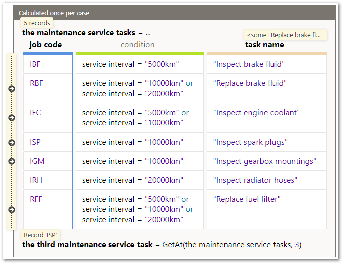

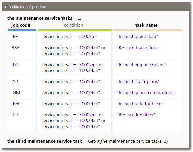

For example, if you had a list of maintenance service tasks, you could get the third task using the following rule.
A rule in a decision service project showing the GetAt function used to get the third maintenance service task
This would return the third maintenance service task as IEC.
If there are conditions on the records in the record list, only the records that meet the conditions are indexed.
A rule in a decision service project showing the GetAt function used to get the third maintenance service task when the service interval is 10000km
In the example above if the service interval is 10000km, you would get 5 indexed records with the third maintenance service task being ISP.
A rule in a decision service project showing the Live view with the GetAt function and 5 records resulting from the inputs

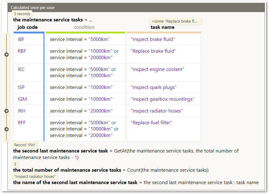

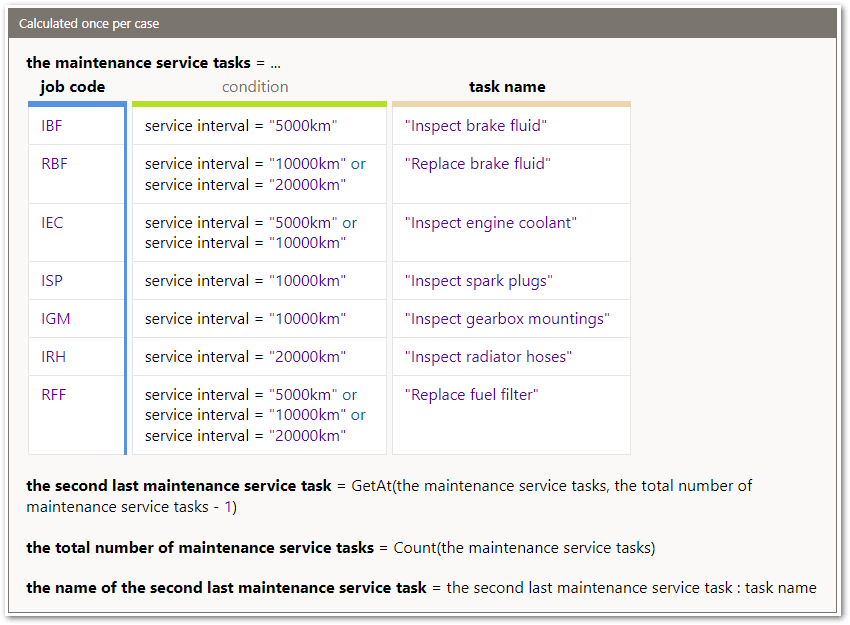

Tip: The index number in the GetAt function can be an expression. For example:
A rule in a decision service project showing the GetAt function used to get the second last maintenance service task
Here the GetAt function uses the total number of maintenance service tasks -1 for the index number, and the total number of maintenance service tasks is calculated in a separate rule using the Count function with the maintenance service tasks. These rules would return IRH for the second last maintenance service task if the service interval is 20000km .
A rule in a decision service project showing the Live view with the GetAt function and 3 records resulting from the inputs
