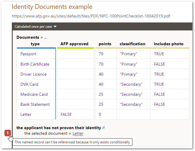

  • Conditional records (that is, a record whose existence is dependent on a condition being true) cannot be referenced in this way and a rule referring to that record will result in an error:
    An object rule table in a flow project showing an identifier column and a condition column and a rule resulting in an error
