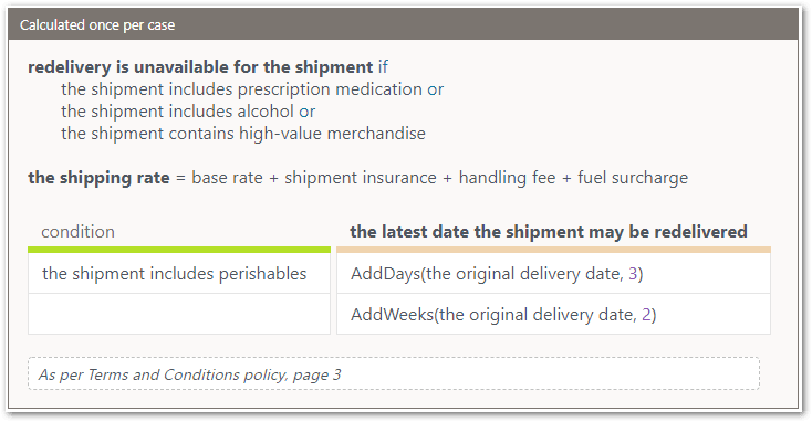

A rule document in a decision service or flow project is made up of plain text and rule blocks.
Rule blocks:
  • can contain Boolean rules, calculation rules, table rules and object rules
  • can contain comment text
  • can contain blank lines
  • can only contain rules for one object
A rule block in a decision service project containing rules, comment text and blank lines
Standard rule blocks have a grey header (as shown above), whereas custom function rule blocks have a brown header (as shown below).
