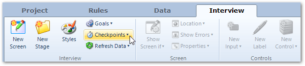

To select the screens that will create checkpoints, in Policy Modeling:
  1. Refresh the Data Model.
  2. On the Interview tab, click the Checkpoints button.
    The Checkpoints button on the Interview tab in Oracle Policy Modeling
    The Checkpoints drop-down window appears.
