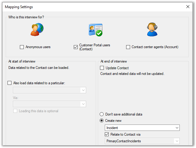

Example 3. Setting up an interview that pre-seeds the interview with Contact data and creates a new Incident record at the end of the interview.
For instance, this may be used for self-service logging of claims or warranty issues by existing customers.
Mapping Settings dialog in Oracle Policy Modeling showing Contact option selected with Create new Incident option selected
Note that if you want to create a single new Incident record that is not related to the Contact at the end of the interview, you should deselect the Relate to Contact via check box.

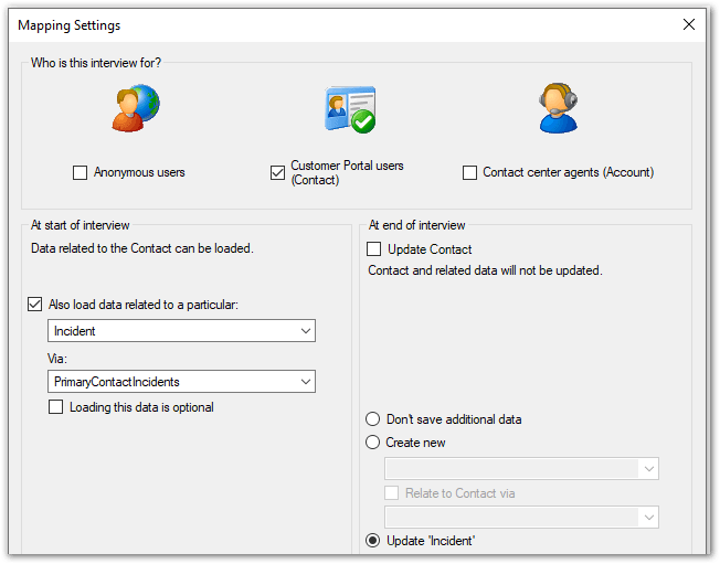

Example 4. Setting up an interview that pre-seeds the interview with Contact and Incident data, and updates the Incident at the end of the interview.
For instance, this may be used for self-service updates to existing customer support issues.
Mapping Settings dialog in Oracle Policy Modeling showing Contact option selected with Incident and PrimaryContactIncidents options and Update Incident option selected
