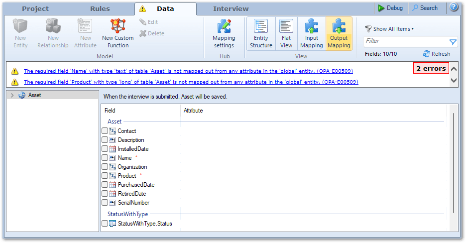

After you have specified what data to save at the end of the interview, on the Data tab:
  • In the Output Mapping view, the left hand pane displays the tables in the application that the global entity in Policy Modeling has been mapped to save data to.
  • Any fields that are required by the application as a result of the mapping to these tables are displayed as errors in the error pane. You can click on an error to highlight the required field (indicated by a red star in the right hand pane). You will need to add mappings for these fields.
The Output Mapping view showing the tables in the connected application that will save data from Intelligent Advisor, as well as the errors for required fields as a result of the global mappings
