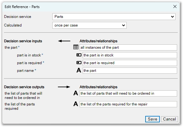

This decision service is referred to in the Policy Modeling project using a decision service reference (Parts.ref). In this file, the relationship in the Policy Model ('all instances of the part') is input mapped to the decision service object ('the part'). The decision service field containing the concatenated list of parts ('the list of parts required') is output mapped to the equivalent attribute in the Policy Model.
The Edit Reference dialog in Policy Modeling showing the mappings for the Parts decision service

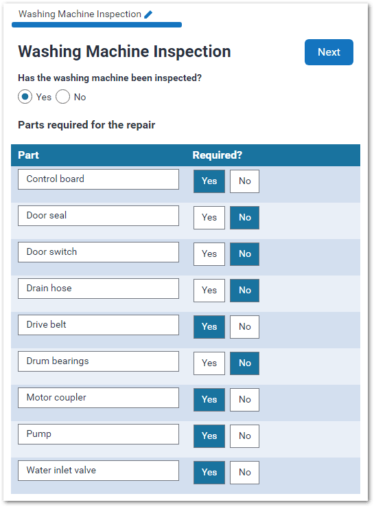

In an interview, the parts required for the repair are collected.
A screen in an interview collecting the parts required for a washing machine repair

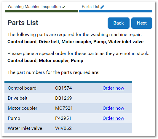

The decision service is then invoked to combine the required parts into a text field separated by commas. This value (for example, 'Control board, Drive belt, Motor coupler, Pump, Water inlet valve') is returned to the interview and displayed on an interview screen.
A screen in an interview displaying the list of parts required for a washing machine repair
