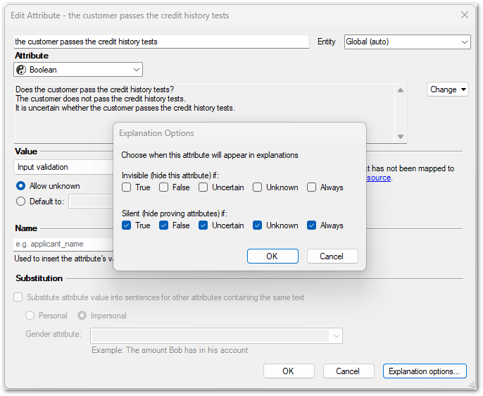

- The silent parameter is used to hide all attributes in the explanation below the attribute on which the parameter is used.

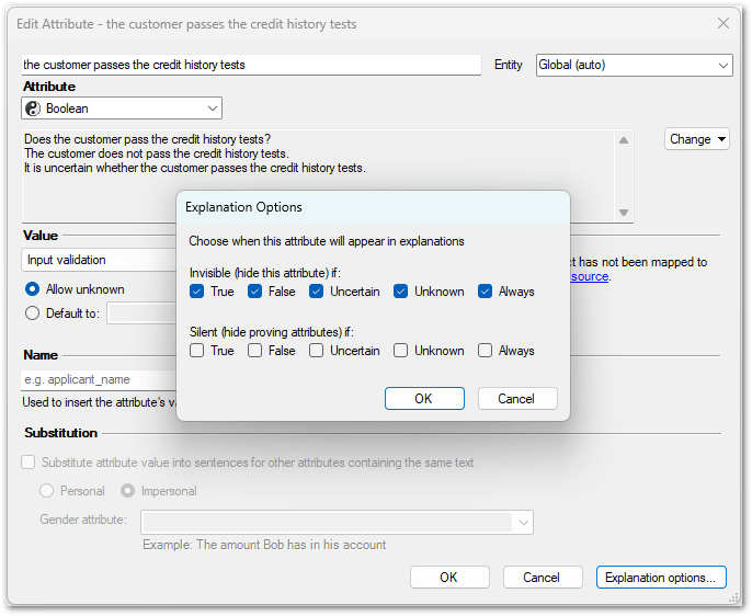

- The invisible parameter is used to hide the attribute on which the parameter is used in the explanation.

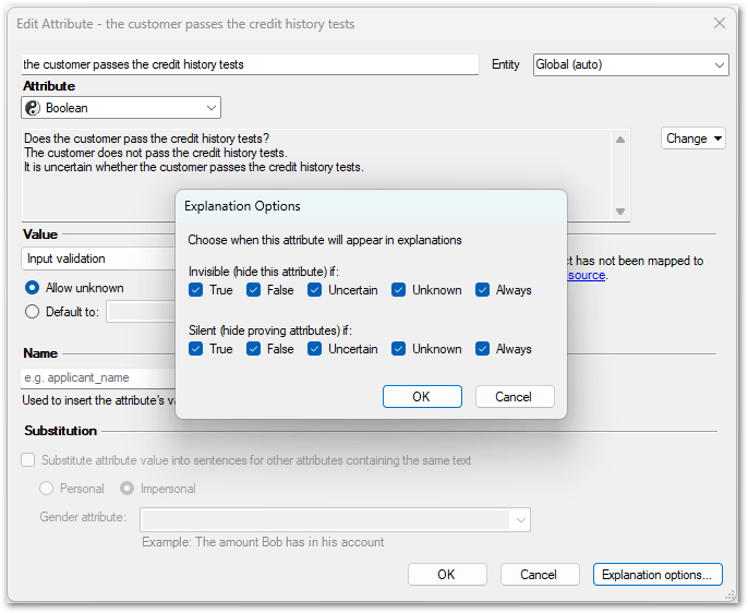

You can also use both parameters together to cut off an explanation above a particular attribute.

Hide all attributes in an explanation below a particular attribute
To apply the silent parameter to an attribute, in Policy Modeling:
- On the Data tab, double-click on the attribute in the attribute list.
- In the Edit Attribute dialog, click the Explanation options button.
- In the Explanation Options dialog, select the appropriate check boxes in the Silent section.
- For Boolean attributes, you can mark the attribute as always silent, or silent only if the attribute is true, false or uncertain.
- For non-Boolean attributes, you can mark the attribute as always silent, or silent only if it is certain or uncertain.
Hide a particular attribute in an explanation
To apply the invisible parameter to an attribute, in Policy Modeling:
- In the Explanation Options dialog, select the appropriate check boxes in the Invisible section.
- For Boolean attributes, you can mark the attribute as always invisible, or invisible only if the attribute is true, false or uncertain.
- For non-Boolean attributes, you can mark the attribute as always invisible, or invisible only if the attribute is certain or uncertain.
Cut off an explanation above a particular attribute
Silent and invisible parameters can be used together so that both an intermediate attribute and any rules that prove that attribute are not included in the explanation. It may help to think of this as "chopping off" the explanation immediately above the attribute to which the pair of parameters is attached.
