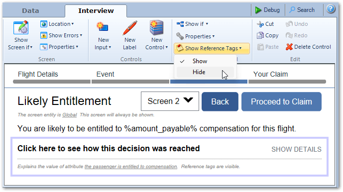

By default, reference tags appear in explanations shown in interviews. The display of these tags can be turned off per explanation. To do this:
  1. In Policy Modeling on the Interview tab, open the screen containing the explanation.
  2. Select the explanation control in the screen list or the screen layout view.
  3. Click the Show Reference Tags button and select Hide from the drop-down list.
    Interview tab in Oracle Policy Modeling showing the Hide reference tags option
    The explanation in the screen layout view is updated to indicate that reference tags are hidden.
    Screen layout view in Oracle Policy Modeling showing that reference tags are hidden for an explanation
