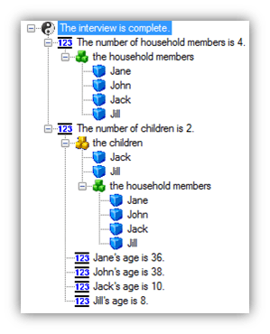

See the examples below with a containment relationship (the household member) and an inferred relationship (the children):
Example 1. A full explanation with no trimming. This shows all household members and all children.
Decision report in Debugger showing no trimming
