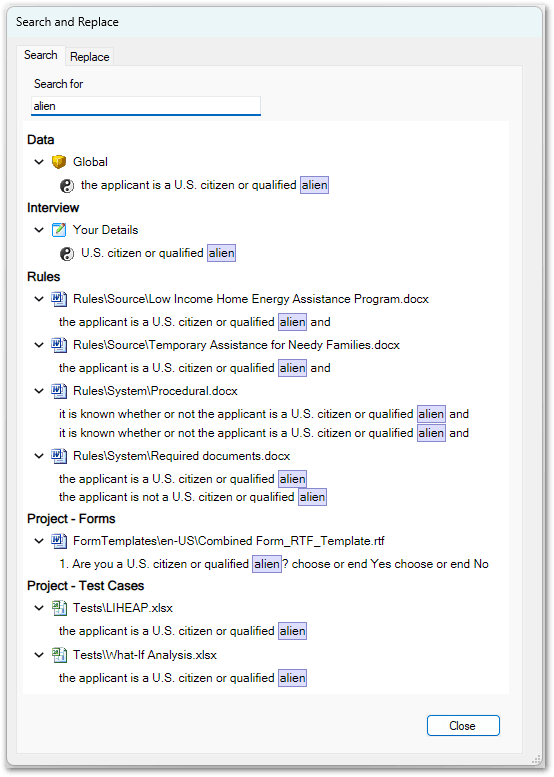

  2. In the Search and Replace dialog, in the Search for field enter the text. As you type, the search results are updated.
    Search results in Oracle Policy Modeling showing everywhere in the project where the search term is used
    Note that the search is not case-sensitive. All of the contexts where the search is performed are given in Table 1 below.
    Tip: You can click on a search hit to close the dialog and navigate to where that hit is located in the project. The granularity of this navigation will take you to the item that contains the hit, but may not put the user interface focus directly on the item.

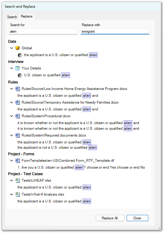

  3. Click the Replace tab.
  4. In the Replace with field, enter the replacement text. Note that the replace text is case-sensitive.
    The Replace with field in Oracle Policy Modeling showing everywhere in the project that the search term is used and will be replaced
  5. Click Replace All. A confirmation dialog will be shown. This will advise how many replacements of the term will be made, and if there are any matches that will not be replaced (see Table 1 for what is searched but is not replaceable).
  6. Click OK. The Replace All operation commences and a dialog shows its progress as it works through the various documents. Once complete, the Search and Replace dialog is closed.
