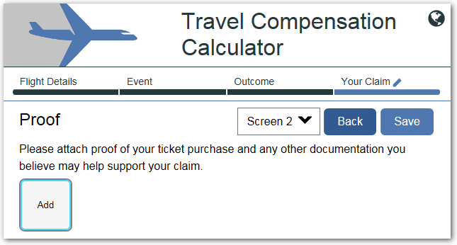

During a web-based interview, the interview user clicks the Add button on the upload control on the screen to select the file they wish to upload.
Interview screen in Web Determinations showing appearance of an upload control

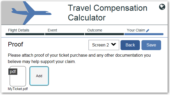

When the upload is complete, the upload control on the screen shows the name of the uploaded file.
Image showing appearance of an upload control on a Web Determinations interview screen once a file has been uploaded

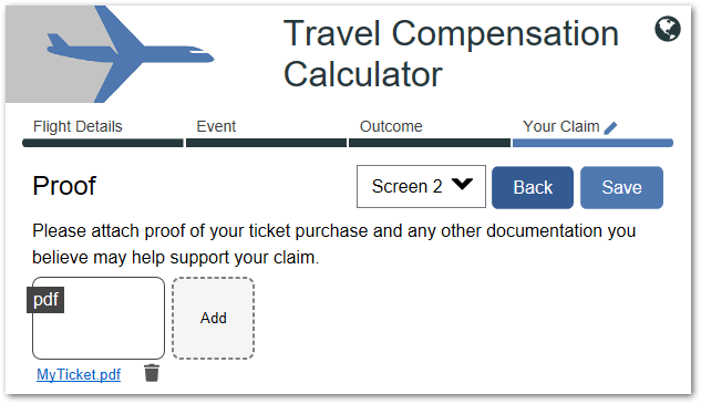

If the interview designer has allowed uploaded documents to be downloaded by the interview user, then the uploaded file name will appear as a link. The user can click on this link to open the file in a new browser tab. (Note that some browsers do not open or download files by default. These browsers should give the user the option to open or save the file when they click the file link.)
The appearance of an upload control that is downloadable, on an interview screen once a file has been uploaded
To delete an uploaded file, the user can:
  • Click the trash can icon (for uploads that are downloadable).
  • Hover over the attachment and click Delete (for uploads that are not downloadable).
An uploaded file with a Delete option
