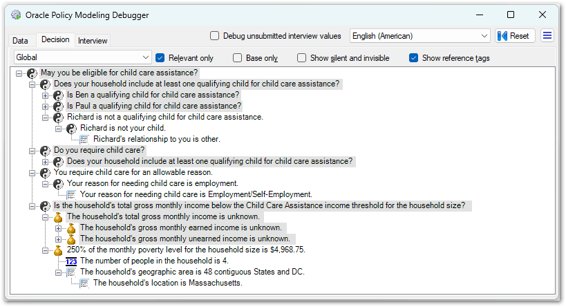

The Decision view in the Debugger presents all the paths for a goal simultaneously, whether the goal is known or not. The decision view is always shown from the perspective of a goal attribute in a particular entity instance. Underneath the goal attribute the decision view displays the attribute instances in a tree.
The user interface of the Decision view in the Oracle Policy Modeling Debugger
Tip: To open all of the nodes below an attribute in the decision tree, right-click the attribute and select Expand All Nodes.

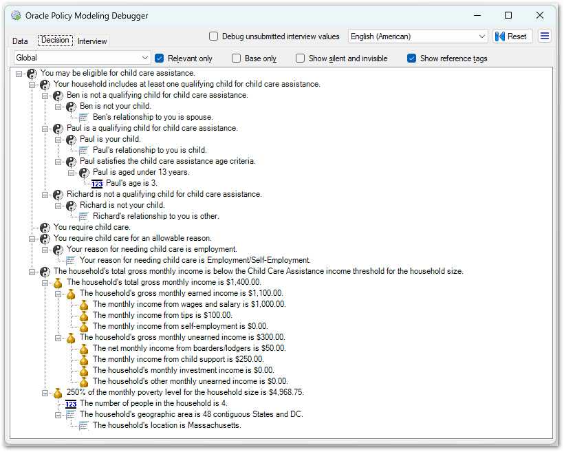

You can set the values for any attributes in the tree. As you provide values for attributes in the decision view, some paths of the decision tree will become irrelevant, others will become known. Eventually there will be no more unknown relevant attributes and the goal itself will become known. When the goal is known, the decision view appears like an explanation showing all the relevant paths that contributed to the goal attribute's value.
Debugger Decision view showing a known goal attribute
