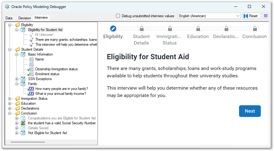

The Interview view in the Debugger has two panes.
The left hand pane shows the list of screens and controls in the interview as defined in Policy Modeling. At a glance you can see the current state of the interview. That is:
  • Any screen or control that is currently hidden is shown as grayed out in the list.
  • Any control that is relevant to the goal is shown with a green tick in the list.
  • Any screen that contains an attribute that is relevant to the goal, but that has not been defined on a screen in Policy Modeling, is shown with a warning symbol to indicate that it is an automatic screen.
  • A submit screen is shown with a save icon.
Debugger Interview view

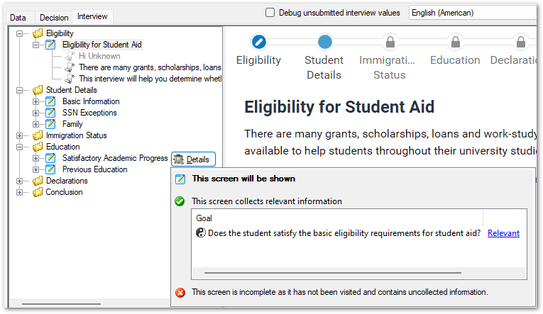

Hovering over any screen or control in the left hand pane will reveal a Details button to the right. Clicking this button accesses additional details about the screen or control such as information about its visibility and relevance.
The screens list on the Debugger showing details for a screen
The screens list on the Debugger showing details for a hidden screen
The screens list in the Debugger showing details for a Submit screen
In the Details window, you can click on:
  • the value link or relevance link to display the Decision view for that attribute
  • a form link to display that form
  • a Why? link to display the Decision view for the attribute used to control when the form is attached
  • a signature link to display the signature image file
Also, in this window, hovering over the document or pen icon displays the file type, file name and entity for the attachment.
