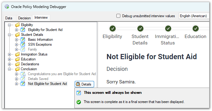

The Details view for a screen shows why a screen has been shown or not.
The Interview tab in the Debugger showing details for a screen that is always shown

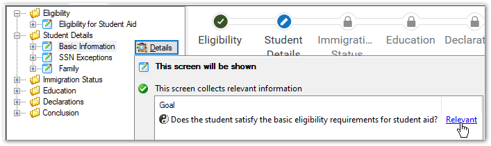

For a screen that will be shown if it collects relevant information, you can click on the Relevant link to display the Decision view for that goal.
The Interview tab in the Debugger showing details for a relevant screen

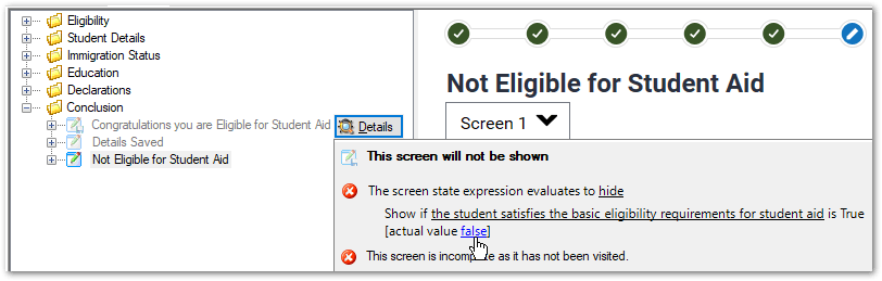

For a screen that will not be shown, you can click on the value link to display the Decision view for the attribute that controls the visibility of the screen so that you can set or change the value to see how this will affect the visibility of the screen.
The Interview tab in the Debugger showing details for a screen that will not be shown

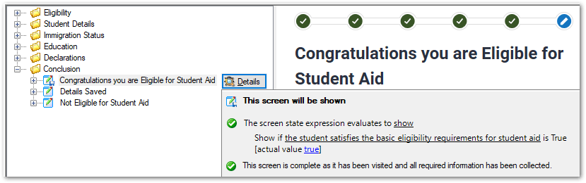

The Interview tab in the Debugger showing details for a screen that will be shown as a result of changes to answers
