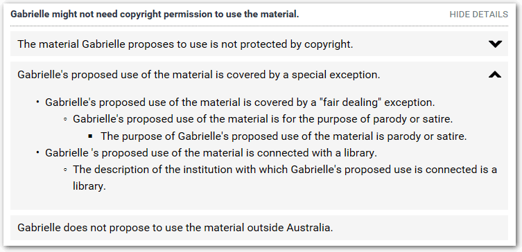

An explanation looks like this:
An explanation shown on an interview screen in the Debugger
You can expand and collapse nodes in the explanation by clicking on the down and up arrows.
