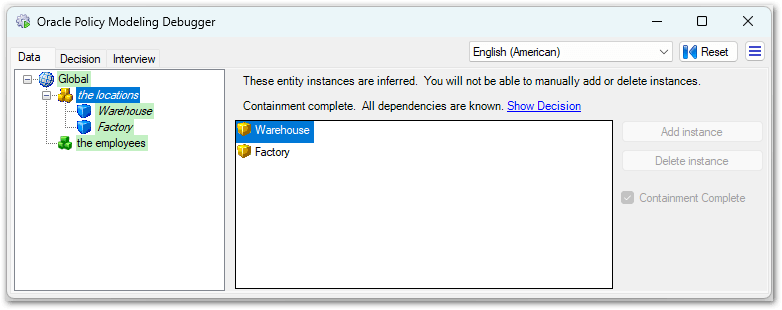

This rule will create instances of the entity "the location" (depending on the assessment date), which are members of the containment relationship "the locations".
These instances will have "Main Office", "Warehouse" and "Factory" as the value of their identifying attributes.
Debugger Data view showing multiple inferred entity instances
