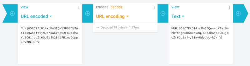

Step 1: URL Decode the Value
To start, the URL decodes the value.
  • Step 1.1: Original value
    Result:
    NUHj658C7FtG14xrMm3EQw%3D%3D%3AXTax9whbftijMDbKpwXVnq%2F83c2hAYd5C01jqcZr6GUZai%2B%2FB1mvGdppsc%2BkJrnV
  • Step 1.2: URL Decoded the value
    Result:
    NUHj658C7FtG14xrMm3EQw==:XTax9whbftijMDbKpwXVnq/83c2hAYd5C01jqcZr6GUZai+/B1mvGdppsc+kJrnV

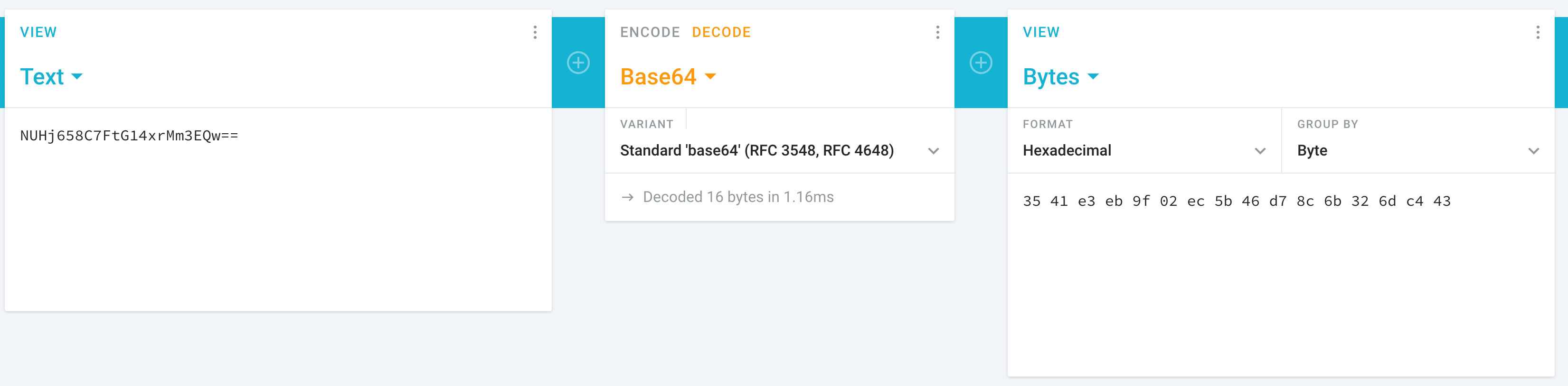

Step 3: Convert to HEX
The Initialization Vector and Data must be converted from Base64 ASCII to HEX. The Encryption key must be converted from text to HEX.
  • Step 3.1: Original values:
    Initialization Vector:
    Data:

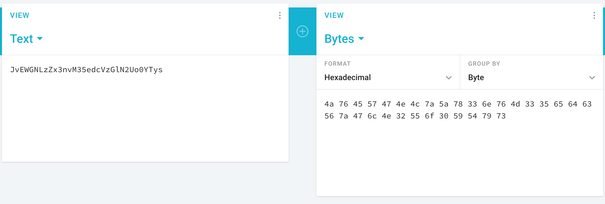

    Encryption key:
    JvEWGNLzZx3nvM35edcVzGlN2Uo0YTys
  • Step 3.2: Convert to HEX
    35 41 e3 eb 9f 02 ec 5b 46 d7 8c 6b 32 6d c4 43

    Encryption key:
    4a 76 45 57 47 4e 4c 7a 5a 78 33 6e 76 4d 33 35 65 64 63 56 7a 47 6c 4e 32 55 6f 30 59 54 79 73

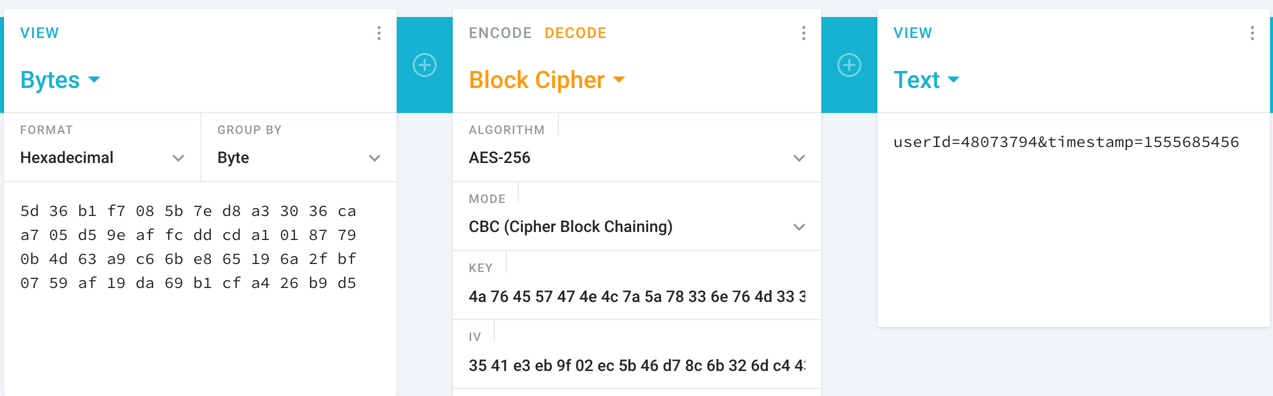

Step 4: AES-256 Decrypt
Using the three HEX values, you can now decrypt the value, using CBC (Cipher Block Chaining).
  • Step 4.1: Original values:
    Data:
    5d 36 b1 f7 08 5b 7e d8 a3 30 36 ca a7 05 d5 9e af fc dd cd a1 01 87 79 0b 4d 63 a9 c6 6b e8 65 19 6a 2f bf 07 59 af 19 da 69 b1 cf a4 26 b9 d5
    Encryption key:
  • Step 4.2: Decrypt
    Result:
    userId=48073794&timestamp=1555685456
    Sample tool:
