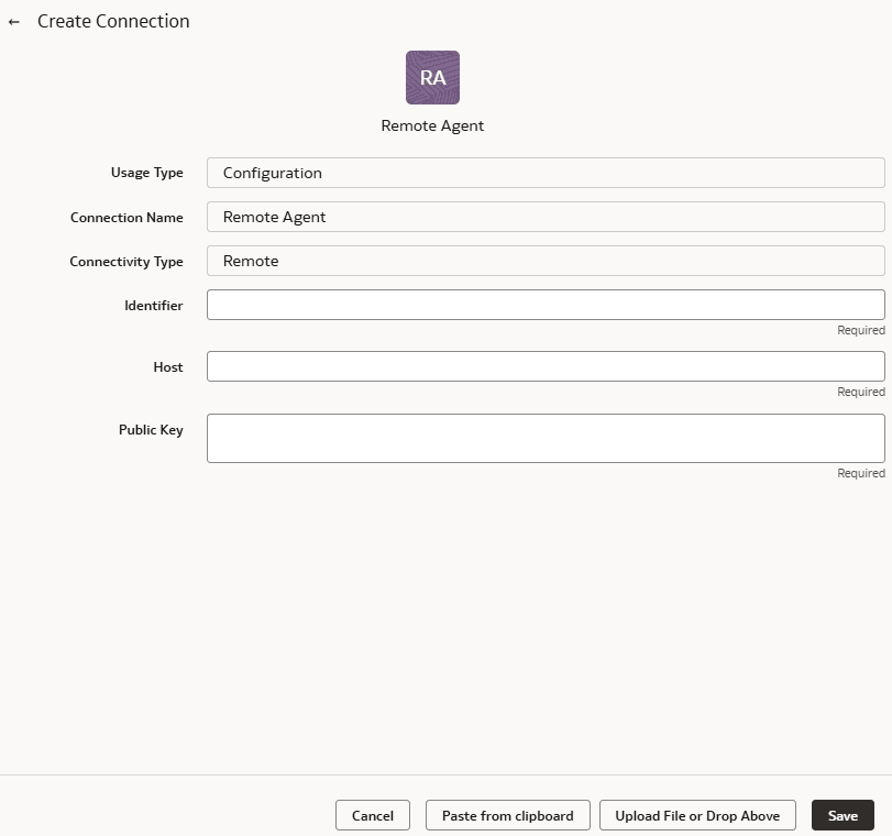

  5. In the Create Connection Remote Agent dialog, in Connection Name, you can modify the default name and verify that Remote is displayed in Connectivity Type.
    Create Connection dialog for the Remote Agent
  6. Populate the Create Connection page.
    1. Click and drag config.json into the dialog, or click Upload File or Drop Above and navigate to select config.json.
    2. To manually populate this page, open config.json, and enter the appropriate values for Identifier, Host, and Public Key.
    3. Click Save
