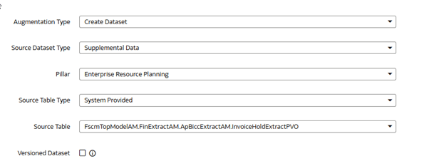

Create a data augmentation extension on Dim – AP Invoices Details, a prebuilt degenerate dimension in the Financials – AP Invoices subject area.
- Create a dataset augmentation type.

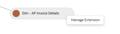

- Using the Sandbox framework, extend a degenerate dimension. In the Financials –
AP Invoices subject area, select Fact – Fins – AP Invoice Schedule.
- Extend the Dim – AP Invoices Details degenerate dimension.

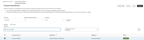

- Enable frequent data refresh on the applicable functional area, which is
Accounts Payables in this case.

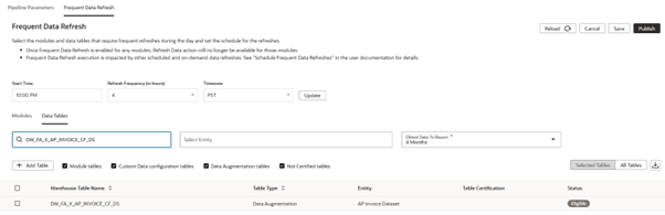

- Enable frequent data refresh on the DW_FA_X_AP_INVOICE_CF_DS table which is the
data augmentation dataset target table in this case.

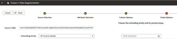

If you've defined augmentation that extends an entity, then you can enable frequent data refresh on the applicable functional area and table to have the ability to include the frequently refreshed data in your workbooks.
- Note the details of a data augmentation that extends an entity,
for example AP Invoice Header.
- Enable frequent data refresh on Accounts Payables, the functional area of the AP
Invoice Header extended entity in this example.
- Enable frequent data refresh on DW_FA_X_AP_INVOICE_CF_EXT, the data augmentation
extension target table.
