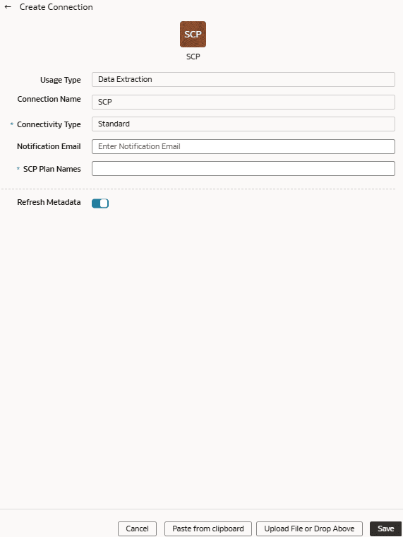

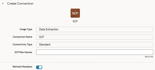

    4. In Create Connection, select Data Extraction in Usage Type and then select Fusion Supply Chain Planning as the connection type.
      Fusion Supply Chain Planning connection option
    5. In the Create Connection dialog, enter these details and then click Save:
      • SCP Plan Names: The applicable plan names in your Fusion Supply Chain Planning instance.
      If you have multiple Supply Chain Plan names, enter them in a comma-separated list with no spaces between plan names.
      Create Fusion Supply Chain Planning connection
    6. Verify that the Refresh Metadata toggle is enabled to ensure that the metadata is refreshed when you save the connection.
