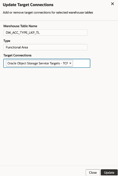

  4. In the Update Target Connections dialog:
    1. Verify that the Warehouse Table Name is automatically populated.
    2. Verify that the connection type in Type displays either Functional Area or another category depending on the table.
    3. Select the Oracle Object Storage Service Targets connection that you created in Target Connections.
    4. Click Update.
