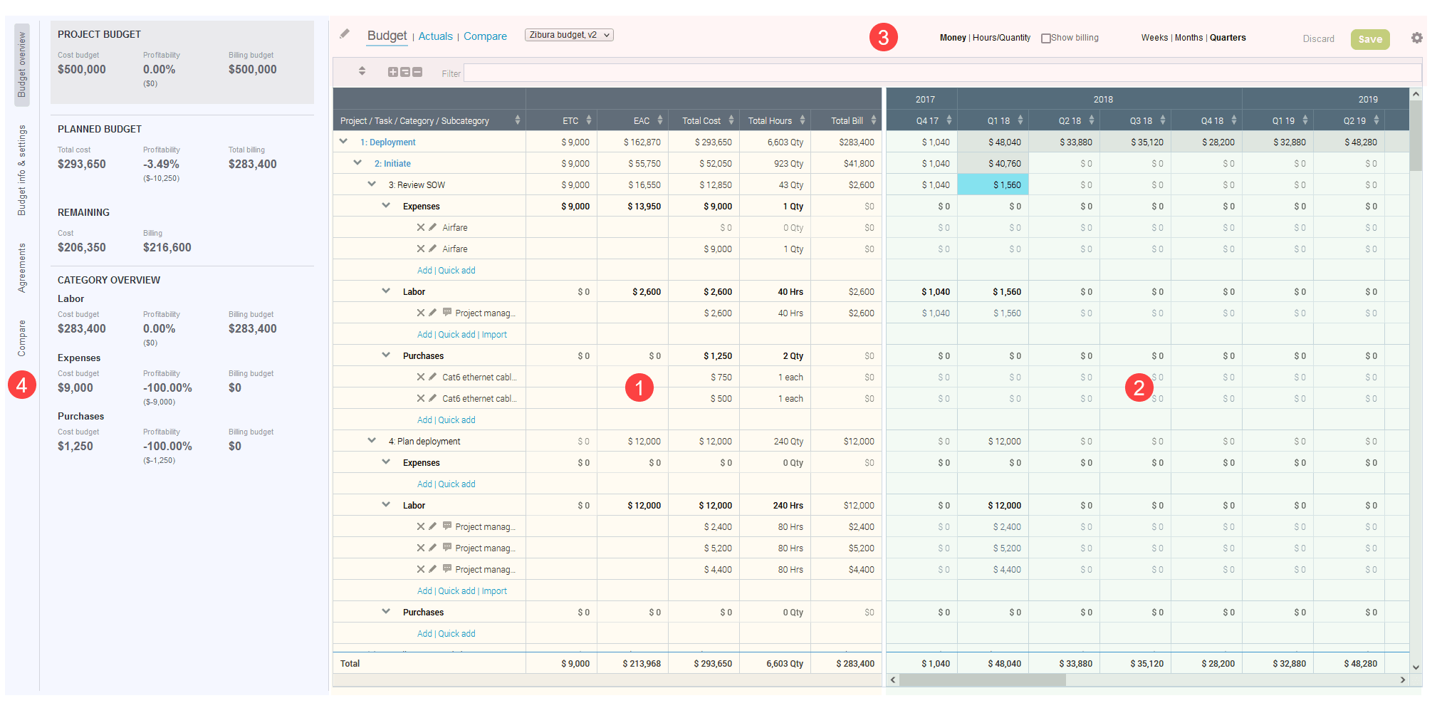

The project budget page includes the following elements:
Summary grid — The left side of the budget grid shows the work breakdown structure for your project, the project costs under Expenses, Labor and Purchases categories, totals and other summary fields. You can add entries under all three categories directly from the grid and import labor entries from task assignments or bookings.
Time grid — The right side of the budget grid shows a detailed breakdown of your budget per week, month or quarter over the span of the project.
Toolbar — Switch between a view showing the budgeted costs, a view showing actual incurred costs, or a view comparing multiple budgets (see Budget, Actuals and Compare Views). Control view options such as the time granularity, the type of values shown (monetary or time and quantity, cost-based or billing-based, along with other list tools (See Project Budget Toolbar).
Information and Settings panel — Vertical tabs include summary information related to your budget and additional settings and controls. See Information and Settings Panel.

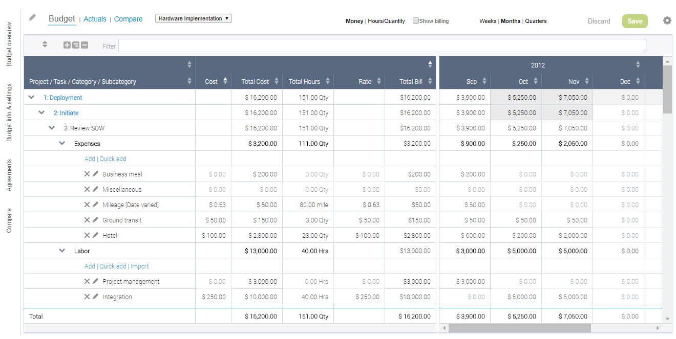

Budget View — Click Budget in the toolbar to show budgeted costs. You can add or modify budget items directly from the summary grid, and edit values for each item in the time grid.

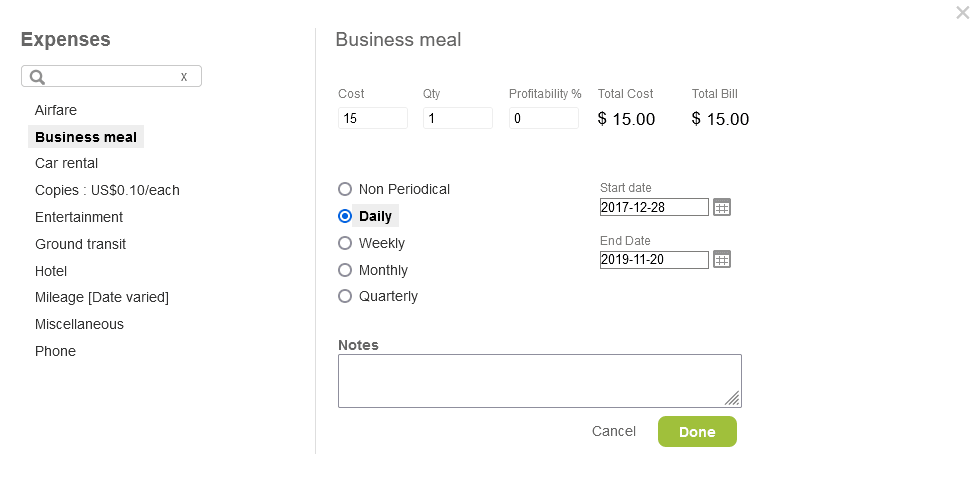

Click Add under the expenses, labor or purchases category to add a budget item. A form appears and lets you enter information for each budget item, including the periodicity for repeat costs.
Click Quick Add under the expenses, labor or purchases category and select a cost item subcategory to add a cost row on the project grid. You can then add cost information directly in the grid using inline-editing.
Click Import to import labor cost items from task assignments or bookings.

Double click a cell on a budget item row in the time grid to enter the budgeted cost, quantity, or number of hours for that budget item in that week. The schedule for each task and phase is indicated on the task or phase row by cells with a blue color background (task) or gray color background (phase).

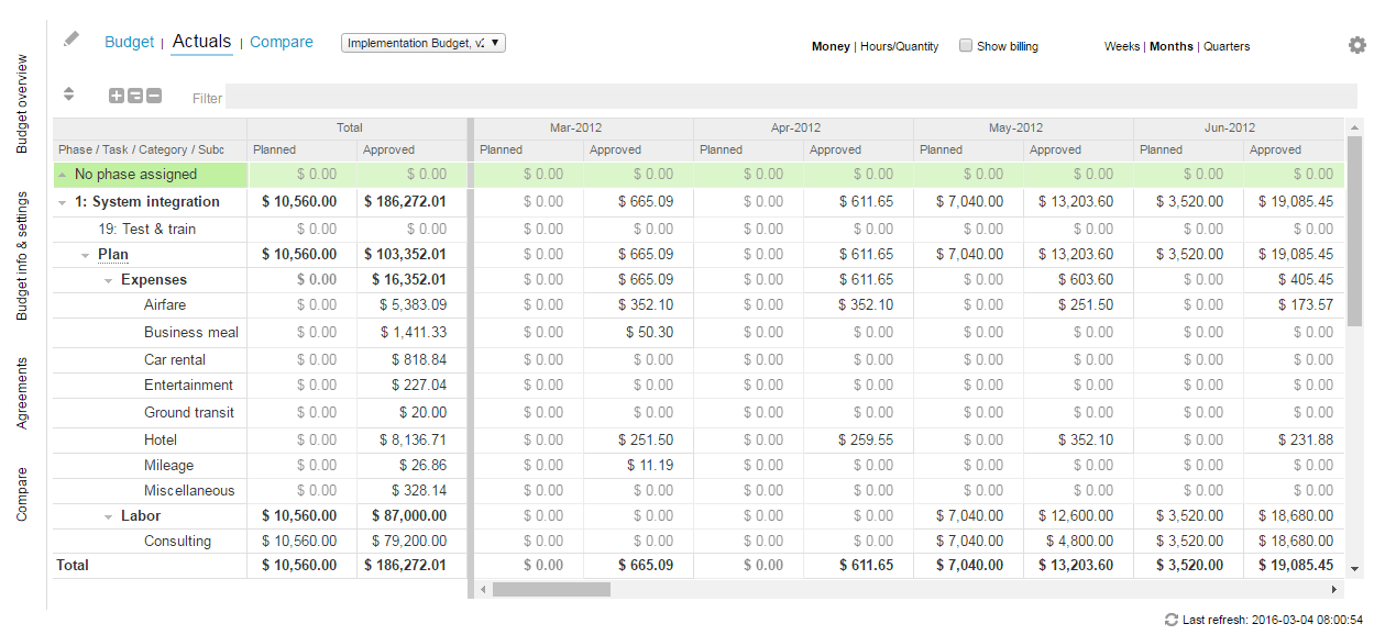

Actuals View — Click Actuals in the toolbar to compare incurred project costs against the planned budget (for cost-based budgets), or actual values from charges and invoices against the planned budget (for billing-based budgets). The summary grid and time grid include columns showing planned and actual values. Actual values are either Approved, Approved excluding taxes, Open, or All.

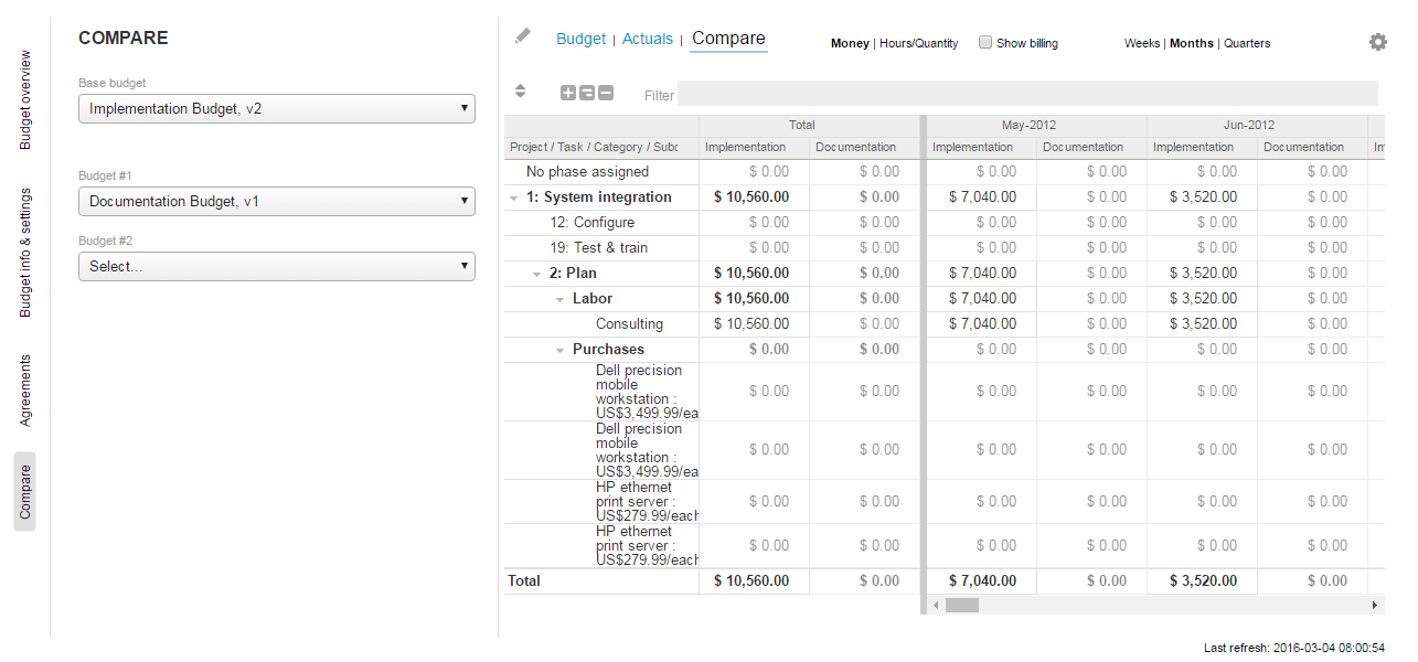

Compare View — Click Compare in the toolbar to compare up to 5 budgets on the same page. Click the Compare vertical tab in the Information and Settings panel, then select a base budget and the budgets you want to compare. To remove a budget from the compare view select Select ... from the corresponding dropdown field.

The Compare tab lets you select a base budget and other budgets you want to compare. To remove a budget from the compare view select Select ... from the corresponding dropdown field. You can compare up to 5 budgets at the same time.
