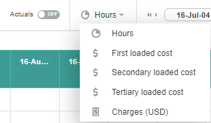

Depending on your account configuration and role permissions, you can view hours, time costs based on the primary, secondary and tertiary loaded cost rates for each resource, and time charges. Select the information you want to view from the measure selector in the toolbar.
The time cost information is calculated based on current and historical loaded cost rates for each resource, including any overrides at the project or task level. If your company uses different loaded cost levels, you can view time cost information based on primary, secondary or tertiary loaded cost rates.
The following table describes the values that are shown depending on the measure selected and on the Actuals switch.

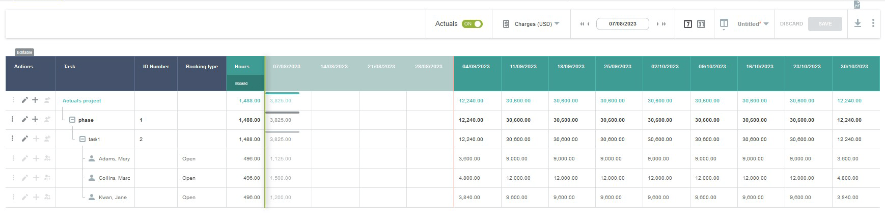

To view hours worked or hours booked in the columns for past weeks or months, toggle the Actuals button in the toolbar.
If the Actuals switch is ON, the project center shows hours worked instead of hours booked in the booking grid columns for past weeks or months:
Hours worked values are sourced from logged time entries against each task or against the project in open, submitted, approved and archived timesheets.
Hours worked values cannot be modified.
The column header background color and the values for past weeks or months are dimmed.

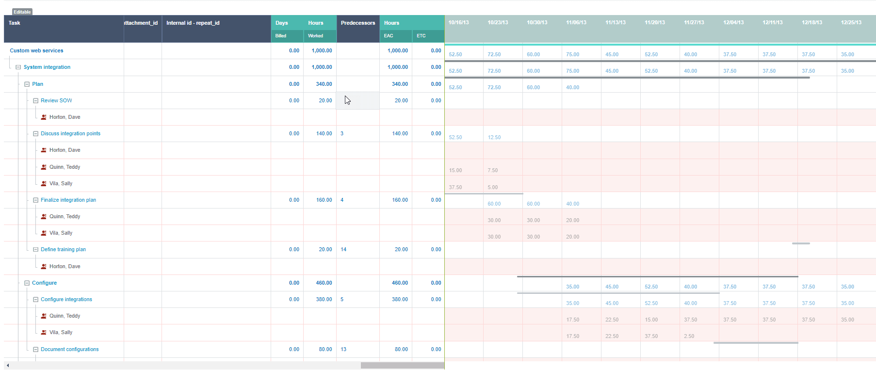

If a resource is not booked to a task in the project but has logged time entries against this task, the project center shows a row for the resource with hours worked. The row has a red background color and an unbooked resource icon
next to the resource name.
Hours booked in the booking grid columns for the current and future weeks or months.
Calculated values for each task, for each phase, and for the entire project under the Hours – ETC and Hours – EAC in the project outline (left side of the project center view).
If the Actuals switch is OFF, the booking grid shows hours booked for past, current, and future weeks or months.
