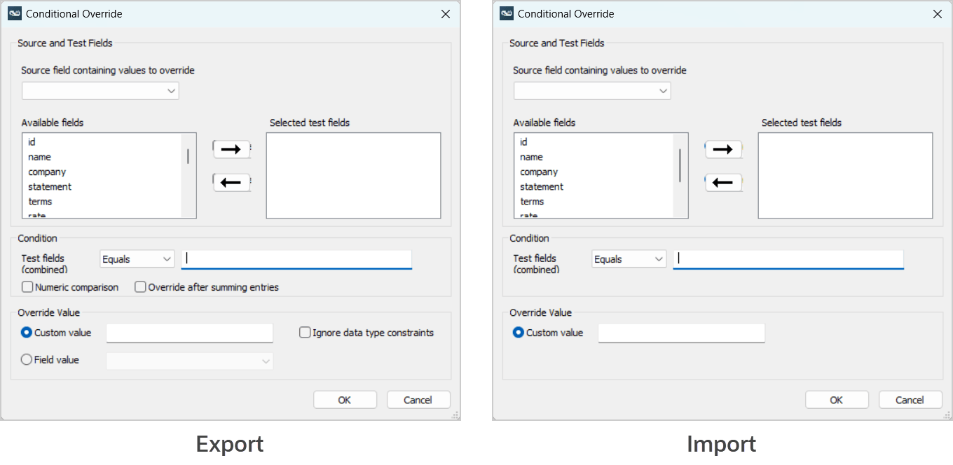

Click Add.
The Conditional Overrides window appears.
Select the Source field containing values to override.
Select one or more test fields (the fields used as first operand in the condition determining if the source field value should be replaced). Use the arrows to add fields to (arrow pointing right), or remove fields from (arrow pointing left) the Selected test field column. If you select more than one field, the logical expression compares the result of concatenating the test field values -or on export, the sum of numeric test field values- with the value or pattern you specify.
Specify the comparison operator and the value or pattern you want to compare the test values with under Condition.
(Export only) Check the Numeric comparison box if you are comparing numeric values.
(Export only) Check the Override after summing entries box if you want to and apply the conditional override to summarized grouped record data. For more information about summarizing grouped record data, see Grouping and Summarizing Record Data and Adding Balancing Entries for Export.
Set the override value. To do so, do one of the following:
Choose and enter a Custom value.
If you select
Regex(regular expression) as the comparison operator, and if the test field is the same as the reference field, Integration Manager substitute the custom value for the portions of the reference field value matching the regular expression pattern. You can include capturing groups in the regular expression pattern and use these capturing groups for string substitution in the custom value. For examples of conditional overrides using regular expressions, see Regular Expressions Use Case Examples.(Export only) You can use any value even if the value is not a valid value for the field data type. To allow any value, independently of the field data type, check the Ignore data type constraints box.
(Export only) Choose and select a Field value from the dropdown options.
Click OK to save the conditional override and return to the Formatting window.

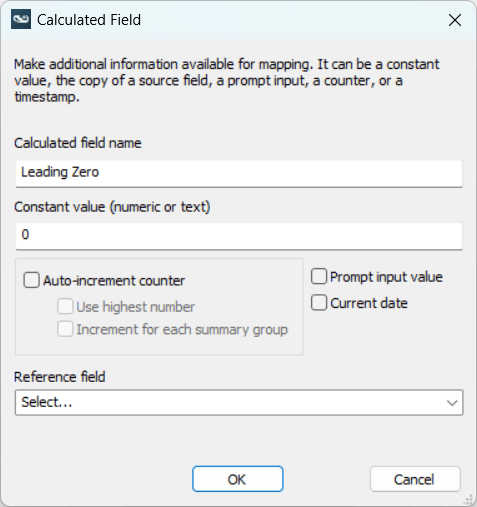

Add a calculated field with the name
Leading Zeroand the constant value0(zero). See Making Additional Information Available for Mapping (Calculated Fields).

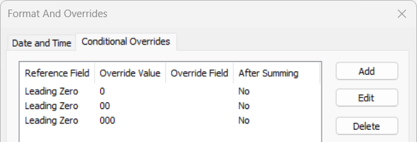

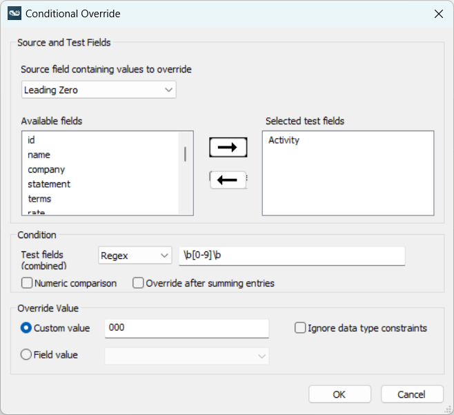

Create a conditional override with
Leading Zeroas reference field,Activityas test field, Regex as comparison operator, enter the pattern\b[0-9]\b, and the custom override value000(three zeros).The regular expression
\bis a word boundary anchor marking either end of a continuous series of non-space characters, and[0-9]is a number digit. The pattern\b[0-9]\bmatches any 1-digit integer values. The conditional override adds three leading zeros ifActivityis a 1-digit integer.
Leading Zeroas reference field,Activityas test field, Regex as comparison operator, enter the pattern\b[0-9][0-9]\b, and the custom override value00(two zeros).The conditional override adds two leading zeros if
Activityis a 2-digit integer.Create a conditional override with
Leading Zeroas reference field,Activityas test field, Regex as comparison operator, enter the pattern\b[0-9][0-9][0-9]\b, and the custom override value0(one zero).The conditional override adds one leading zero if
Activityis a 3-digit integer.
