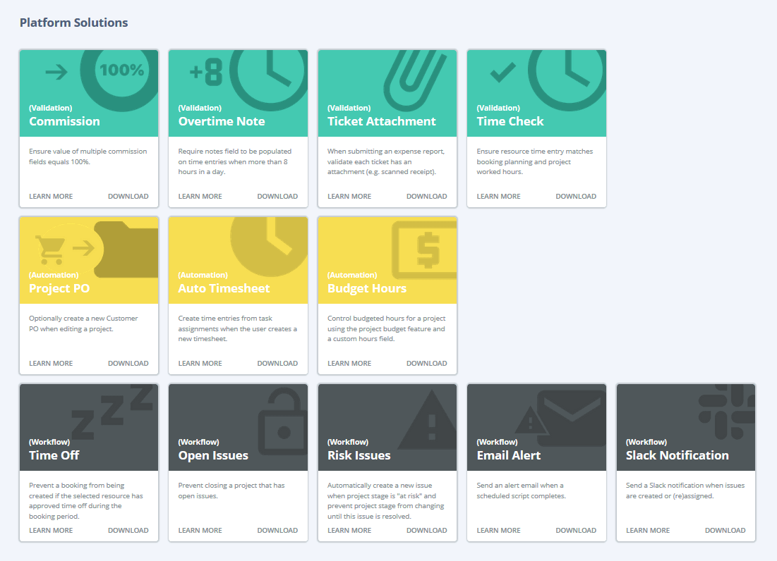

Platform Solutions Catalog
Find the real world use case scripting examples on the Platform Solutions catalog page in SuiteProjects Pro Help Center.
To view the platform solutions catalog, go to User Menu > Help > Platform Solutions. The page lists all the real world user scripting examples described in this guide. Solutions are color coded by category — Validation, Automation, Workflow — with a visual representation and a short summary to indicate the purpose of each solution.
To save the solution XML file, click the DOWNLOAD link. You can then import the solution file from the Scripting Center in SuiteProjects Pro.
To read the help topic describing the solution, click the LEARN MORE link.
