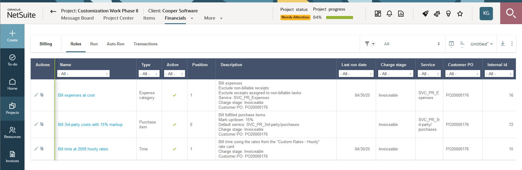

Billing
You can set up detailed billing rules on a project-specific basis. After you have created a billing rule and run it, SuiteProjects Pro creates charges based on the rule which can then be used in invoices.
Types of Billing Rules
There are five types of billing rules:
Time billing rule — These rules are applied to your employees’ time entries which are associated with a project. Only approved time entries are used by this rule.
Expense item billing rule — These rules are applied to approved receipts associated with a project.
Fixed fee on date or milestone — Use these rules to create a fixed fee or repeating fixed fee for a project. This rule is useful for charging monthly flat rates to customers for work on a specific project.
Fixed fee on % complete — Use these rules to bill a certain amount when a project, project phase, or project task reaches a set percentage of completion.
Purchase item billing rule — Use these rules to bill purchases made through the Purchases module.
Billing Rule Forms
Use the Billing Rule form to set the parameters for your billing rules. Each billing rule type has its own form:

To create a billing rule:
Go to Projects > Projects > [select a project] > Financials > Billing > Rules. A list of existing billing rules appears.
Click the Create button and click the type of billing rule you want to create under “Billing rule”. A form for the selected billing rule appears.
Set the parameters for the billing rule, and click Save or Save & create another.

To run a billing rule for one project:
Go to Projects > Projects > [select a project] > Financials > Billing and click the Run tab.
If desired, enter a Start date and End date for the billing run. Click Next.
Note:The Start and End dates default to the values you entered when you last ran billing for the project.
The list of available billable items appears. If no items are billable, a “Nothing is currently billable for this project” message appears. To edit any items in the list, click the date of the billable item you want to change. Make any changes and click Save.
Select the items which you want to create charges for.
Click Create project billing transactions and charges at the bottom of the billable items list.
