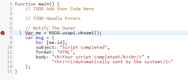

There are three types of errors you need to remove from your scripts.
Syntax errors — These errors can be caught before your script is executed. Syntax errors are displayed in the Editor.
For example:
SuiteProjects Pro checks scripts for correct syntax before allowing them to be deployed. An error is displayed if you attempt to deploy a script with syntax errors.
Note:This error is caused because Var had been typed in place of var, JavaScript is case sensitive. See Variables for more details.
