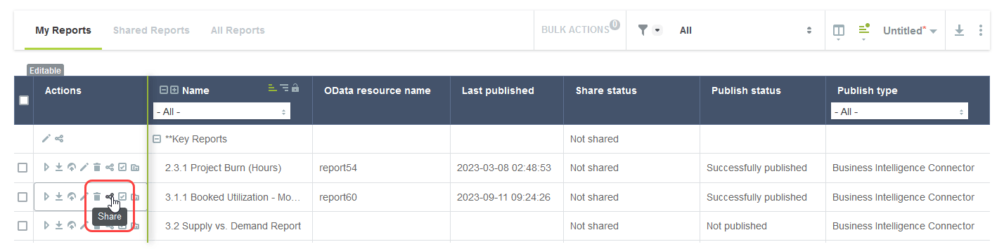

Go to Reports > Saved reports > My reports.
Click the share icon

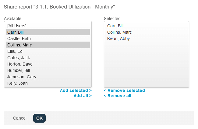

in the Action column corresponding to your report. The Share report dialog appears.Note:To give other employees access to published report data, you must first share the report with these same employees.
Add the employees you want to share the report with to the Selected column.

In SuiteProjects Pro, go to Reports > Saved reports > My reports.
for your published shared report. The Share report dialog appears. -
To give an employee access to your published report, add the employee to the Selected column. To remove an employee’s access to your published report, remove the employee from the Selected column.
Click OK then click the Click here link to close the confirmation dialog and refresh the saved reports list.
