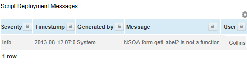

The log indicates:
Severity — The supplied severity: “fatal”, “error”, “warning”, “info”, “debug”, or “trace”.
Timestamp — The time the message was logged.
Generated by — For example, whether the message was generated by your script or by SuiteProjects Pro
Message — The full message text.
User — For example, the user that was saving the form when the error occurred.
If you have a syntax error or a runtime error you will see an error in the log generated by SuiteProjects Pro.
See also Form script deployment logs.
