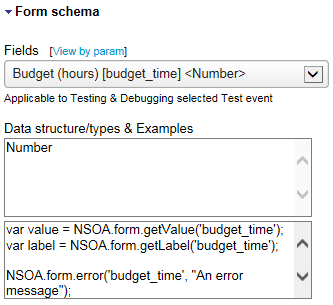

The Fields drop-down list at the top gives a complete list of the available fields on the form. You can select between View by param or View by label by clicking on the link.
If View by label is selected (default), each entry in the drop-down list has the following format:
Label [Field] <Data Type>
Budget (hours) is the label the user sees on the form.
Budget_time is the field name you need to use when calling NSOA Functions.
Number is the internal data type JavaScript will use for a variable created for this field. See Dynamic Data Types.
If View by param is selected, each entry in the drop-down list has the following format:
Field [Label] <Data Type>

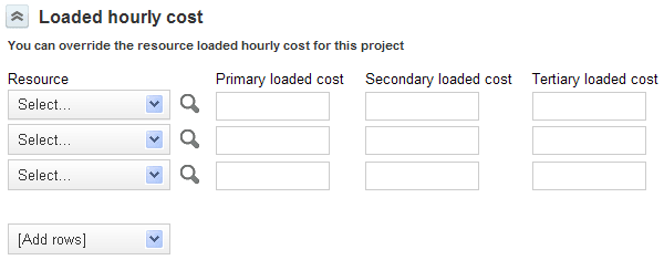

For example, consider the Loaded hourly cost form section.
All these fields are exposed through one loaded_cost field <Object>.
Notice the way the Loaded hourly cost fields map to the data structure you need for your script.
The data structure has three blocks that correspond to the three rows of fields in Loaded hourly cost form section.
