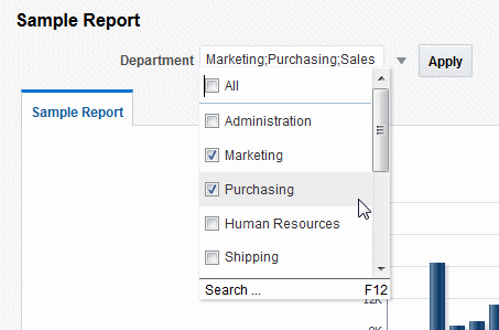

Create a Menu Parameter
A Menu type parameter presents a list of values to the user.
You must define the list of values first. The Menu type parameter supports the data types of String and Integer only. If the number of values in the list exceeds 999, then use a Search parameter instead of a Menu type parameter.
To create a menu parameter:
The figure below shows how the Department menu type parameter displays to the report consumer when multiple selection isn't enabled.
The figure below shows how the Department menu type parameter displays to the report consumer when multiple selection is enabled.

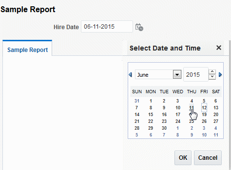

Define a Date Parameter
The Date type parameter provides a date picker to prompt the user to enter a date to pass as the parameter to the data source.
The figure shows how the Hire Date parameter displays to the report consumer.
