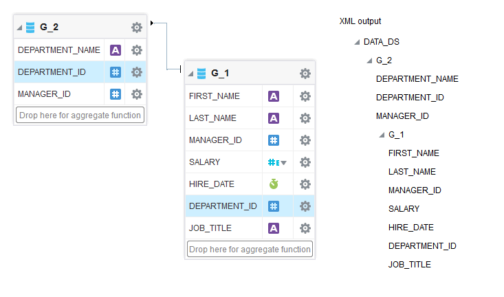

A group-level link defines a master-detail relationship between two datasets.
The following figure shows two datasets with a group-level link defined and the resulting XML data structure.
