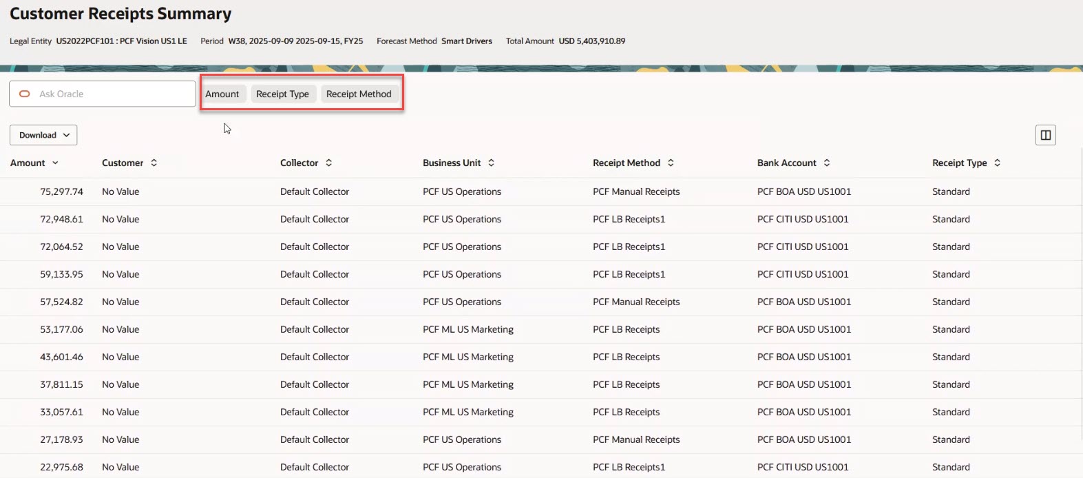

    Drill-through data for Customer Receipts
    Make sure pop-ups are allowed in your browser for your server URL.
  5. To filter the displayed data:
    • Click a filter chip and then select or enter filter values to filter the data.
      Filter chips
      The filter options vary depending on the line item category.
    • Enter search text in the text box.
  6. To download the data to a .CSV file, click Download and then select from the following:
    • All Aggregate Transactions—Exports the aggregated data from the current POV and combination of currency and date. The exported data is not filtered if any filters have been applied.
    • All Transactions—Exports all the detailed transactions that make up the total aggregates from the current POV and combination of currency and date.
  7. To drill through on another line item category, return to the View by Forecast Method form and select a line item category from the Line Item list.
