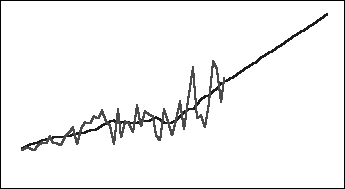

Applies SES twice, once to the original data and then to the resulting SES data. Predictive Planning uses Holt’s method for double exponential smoothing, which can use a different parameter for the second application of the SES equation.
This method is best for data with a trend but no seasonality. It results in a straight, sloped-line forecast.
Figure A-4 Typical Double Exponential Smoothing Data, Fit, and Forecast Line
Upward trending graph of double exponential smoothing historical and forecasted data
