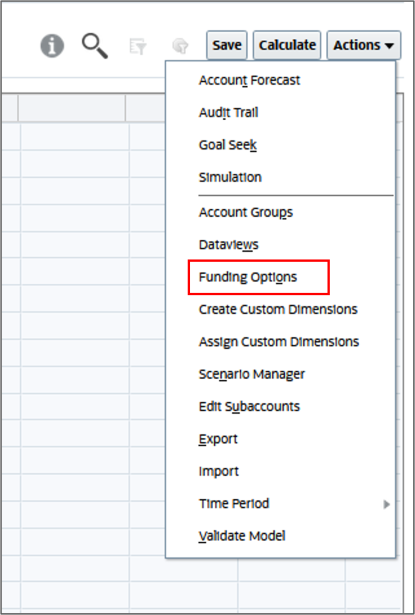

  5. Click Actions, then select Funding Options.
  6. Open funding options
    Tip:
    Note:In Funding Options, you can review and edit the funds that receive cash surpluses and fund cash deficits. In the top (FIRST) section, zero-based accounts are listed. The bottom (LAST) section is for the excess account, which has no maximum. The middle (NEXT) section lists the accounts used to either apply surpluses or fund deficits. You can add or reorder funds in this section.

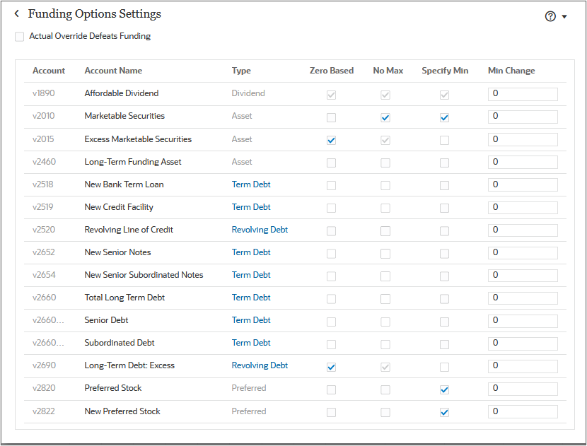

  7. Click Open Settings (Open Settings) to review fund settings. Each fund has a type classification such as Asset or Term Debt. In this example, zero-based funds include Excess Marketable Securities and Long-Term Debt: Excess.
  8. Funding Options Settings
    You can configure funds to have no maximum. By default, minimum account values are zero, but you can specify whether users can set a minimum value used for the fund. You can also indicate whether a minimum change amount is required before an account can be used as a source or use of funds. While you can adjust these options at any time, they are typically set only once.

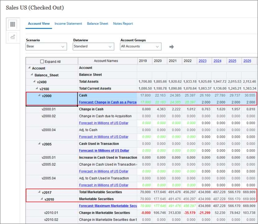

  1. First, review the forecast for cash and securities. In the Account Groups drop-down, select All Accounts, and then click Refresh (Refresh).
  2. Notice that the Cash balance is forecast to increase over time, as is the balance for Marketable Securities.
  3. Cash and marketable securities forecast

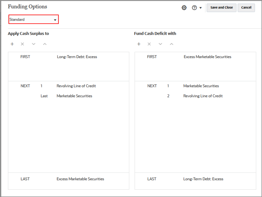

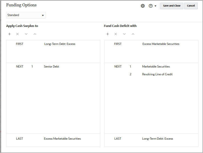

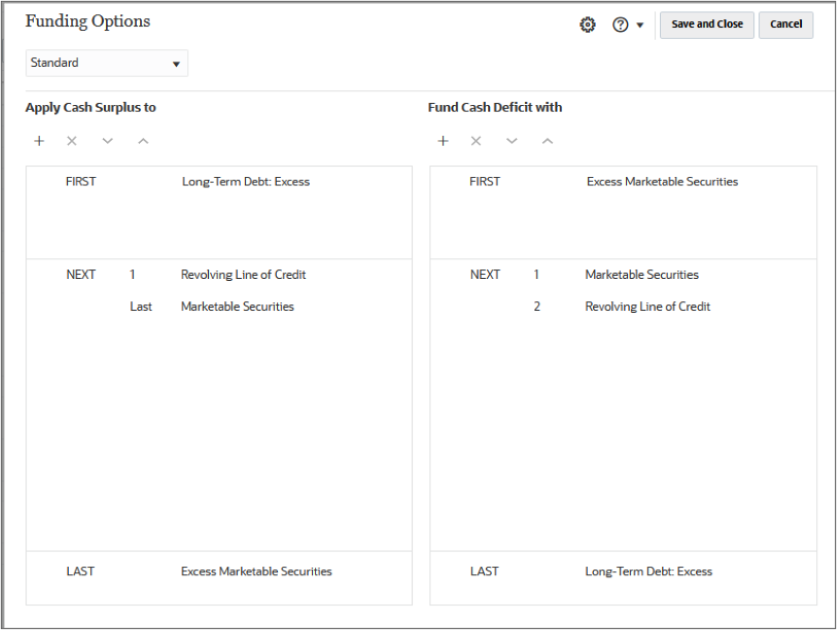

  4. Open Funding Options again. We're using the Standard method, which focuses on balancing the total sources of funds with the total uses of funds. Currently, excess cash is used to pay down Revolving Line of Credit and then accumulates in Excess Marketable Securities. Cash deficits are funded by selling Marketable Securities and issuing Long-Term Debt: Excess.
  5. Standard method funding options

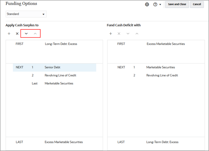

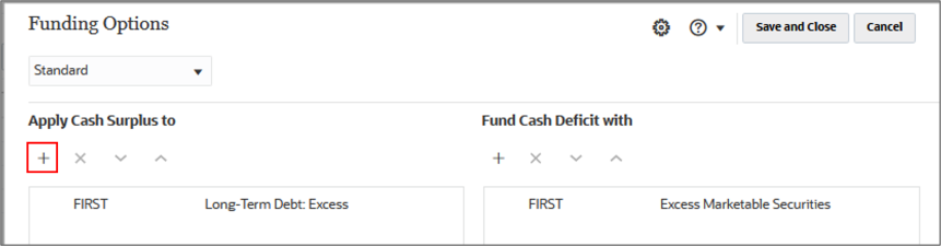

  1. Under Apply Cash Surplus to, click Add Account (Add Account).
  2. Surplus Accounts, Senior Debt selected
  3. Select Senior Debt, then click Add.
  4. Surplus Accounts, Senior Debt selected

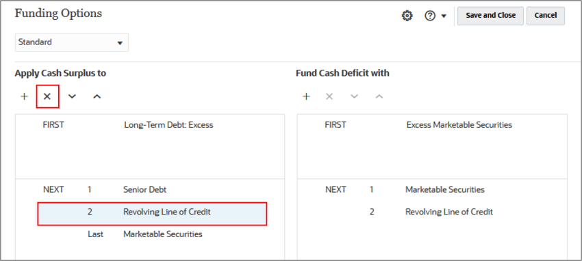

  5. Use the Move arrows to change the order of the funding routine for surplus:
    • 1. Senior Debt
    • 2. Revolving Line of Credit
    • Last: Marketable Securities
  6. Surplus Accounts, change order
  7. You can remove fund accounts too. In the Surplus section, select the Revolving Line of Credit account and click Delete Account (Delete Account).
  8. Delete Revolving Line of Credit
  9. Delete the Marketable Securities account from the Surplus section too, so excess cash is applied only to Senior Debt.
  10. Final cash surplus funding routine
  11. Click Save and Close to finalize the new funding routine.

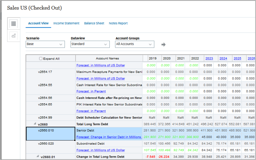

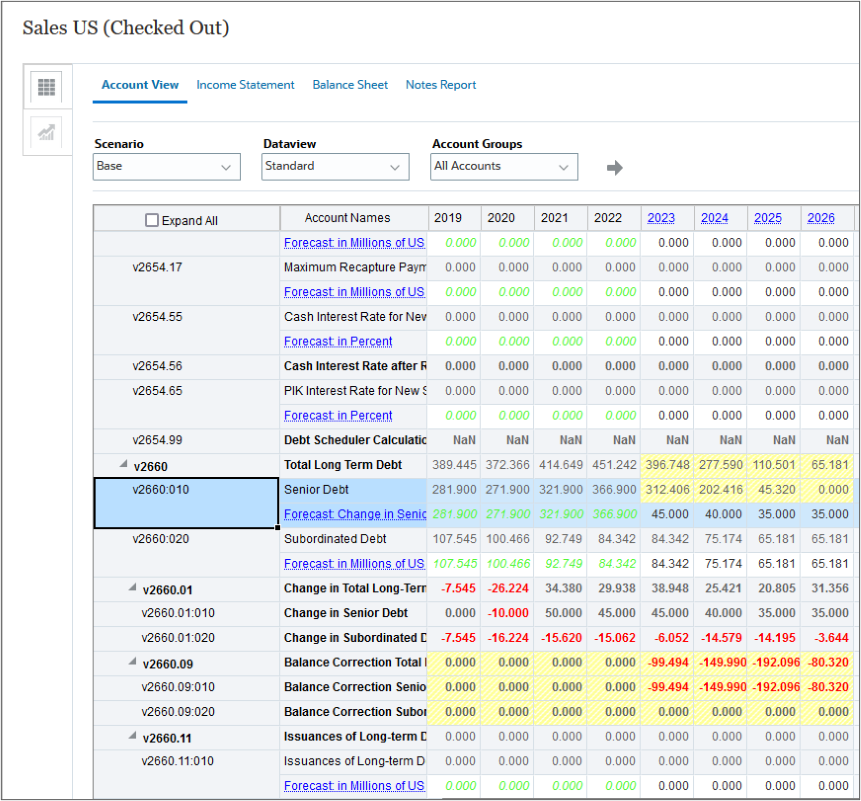

  1. Click Find Account (Find Account) and enter v2660:010. Select the row for Senior Debt in the search results and then click Select.
  2. Search results for Senior Debt
  3. Senior Debt is highlighted in the Account View. Note the current values for Senior Debt.
  4. Senior Debt values before changing forecast

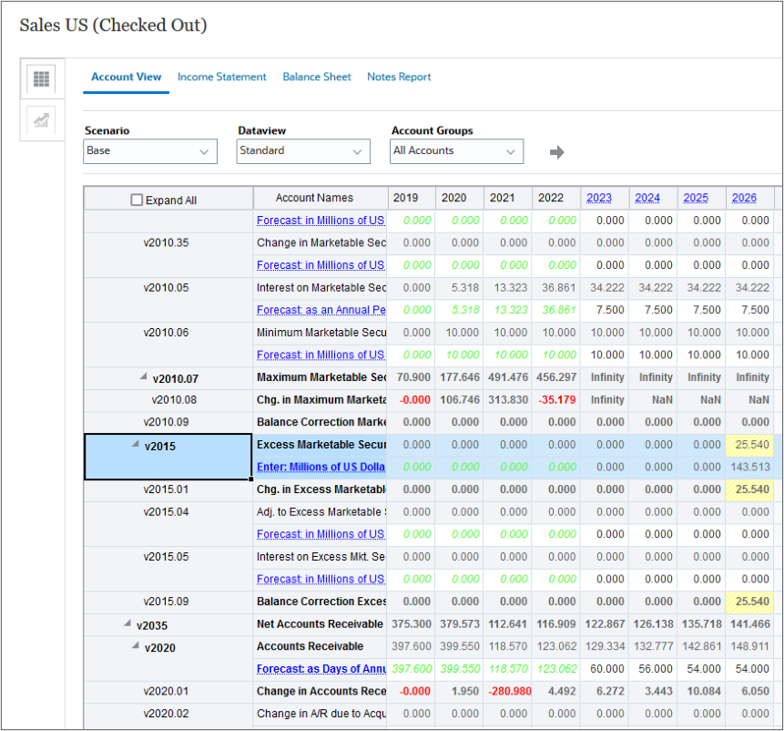

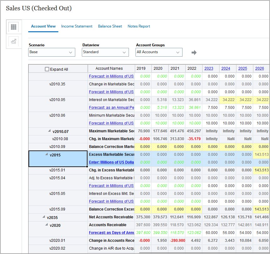

  5. Click Find Account (Find Account) and enter v2015. Select the row for Excess Marketable Securities in the search results and then click Select.
  6. Excess Marketable Securities values before changing forecast
    Note the current values for Excess Marketable Securities.

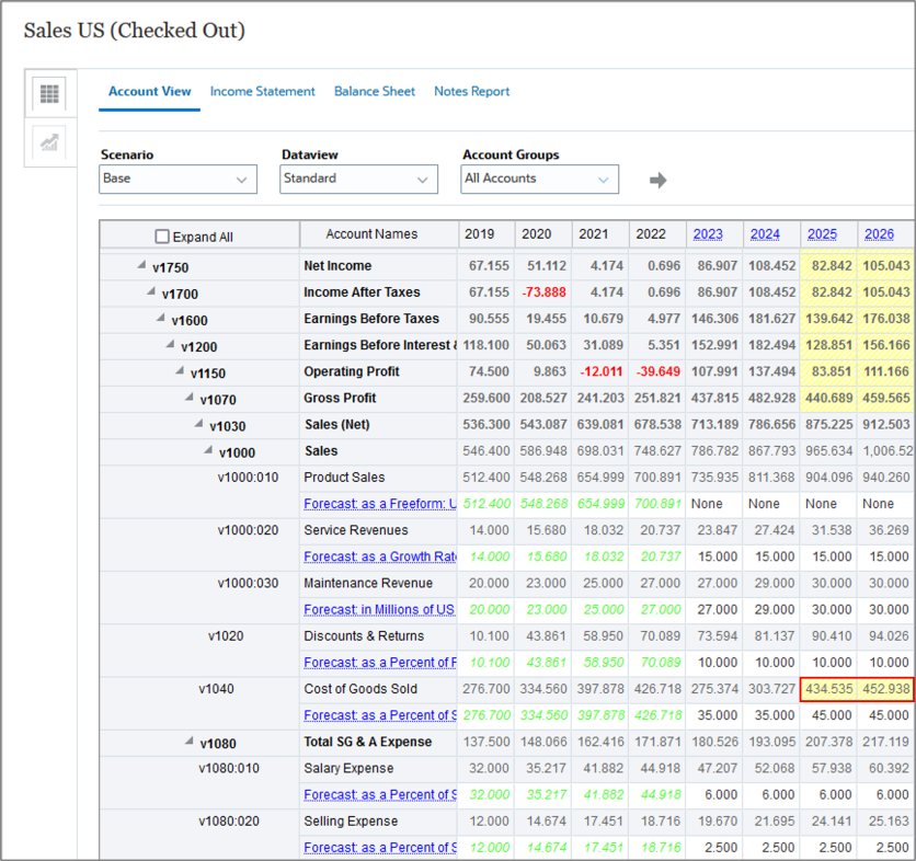

  1. Click Find Account (Find Account) and enter v1040. Select the row for Cost of Goods Sold in the search results and then click Select.
  2. In the Forecast: as a Percent of Sales row for Cost of Goods Sold, enter values for the following years:
    • 2023: 35
    • 2024: 35
    • 2025: 35
    • 2026: 35
    Decrease cost of goods sold
  3. Click Save.
  4. Decrease cost of goods sold

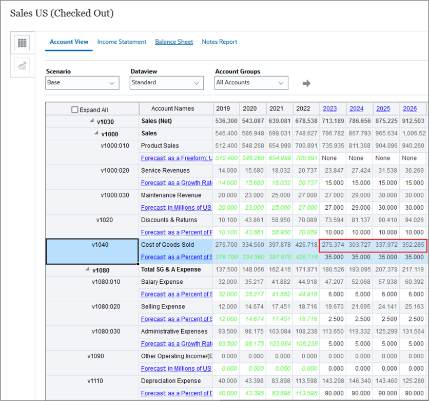

  5. Click Calculate, then select Current Scenario.
  6. Decrease cost of goods sold
  7. The values for Cost of Goods Sold are reduced.
  8. Decrease cost of goods sold
  9. Check the new values for Senior Debt. Click Find Account (Find Account) and enter v2660:010. Select the row for Senior Debt in the search results and then click Select.
  10. Senior Debt values after increasing cash
    Notice that the values for Senior Debt were reduced when the excess cash was applied by the surplus funding routine.
  11. Next, check the values for Excess Marketable Securities. Click Find Account (Find Account) and enter v2015. Select the row for Excess Marketable Securities in the search results and then click Select.
  12. Excess Marketable Securities values after increasing cash
    Notice that Excess Marketable Securities have been increased by the cash surplus.

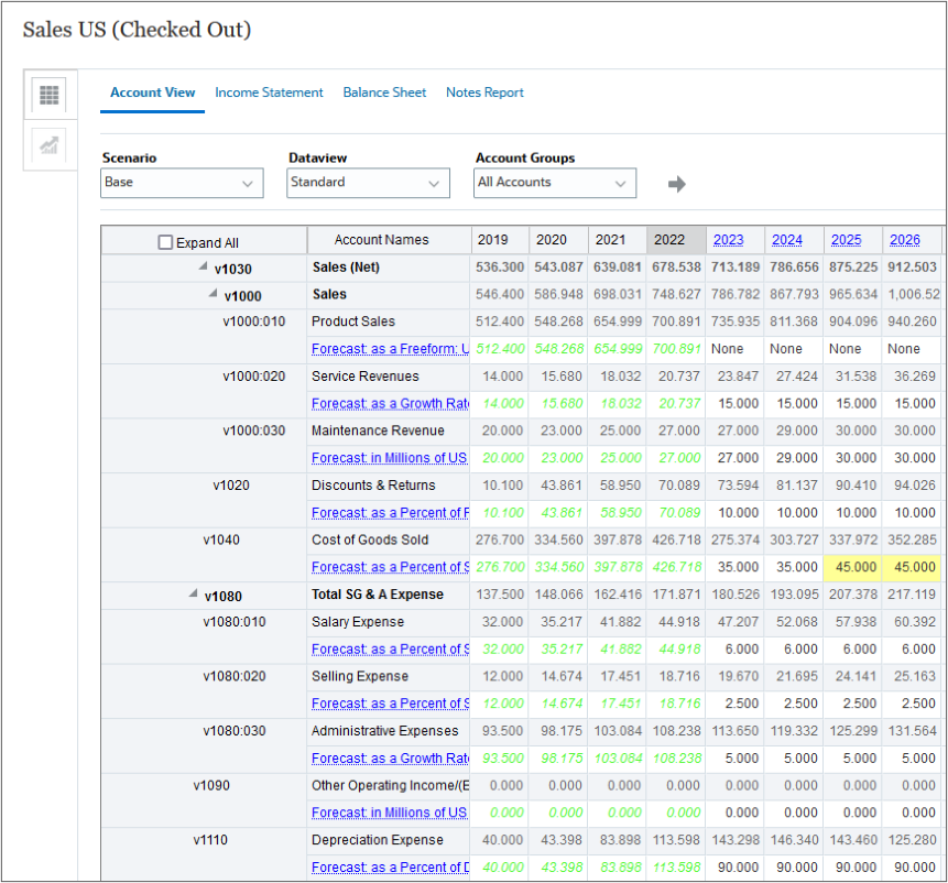

To further test the funding routine, increase the forecast for cost of goods sold for 2025 and 2026 only, which decreases operating revenue and available cash. Decreasing the available cash will reduce Excess Marketable Securities.
    • 2025: 45
    • 2026: 45
    Increase cost of goods sold
  3. Click Save.
  4. Click Calculate, then select Current Scenario. The values for Cost of Goods Sold are increased.

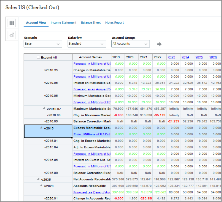

  6. Check the values for Excess Marketable Securities. Click Find Account (Find Account) and enter v2015. Select the row for Excess Marketable Securities in the search results and then click Select.
  7. Excess Marketable Securities values after decreasing cash
    Notice that Excess Marketable Securities were reduced to account for the shortage.
