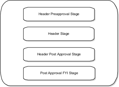

The following figure depicts the stages seeded for requisition approvals and also indicates that the stages are seeded in sequence.
Approvals are routed through the seeded stages in the following sequence:

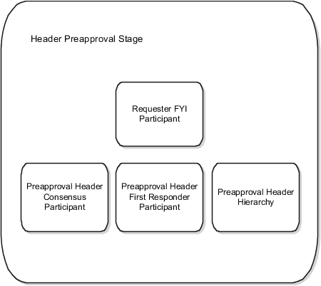

Header Preapproval Stage
The following figure shows seeded participants in the header preapproval stage. -

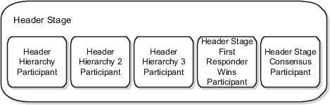

Header Stage
The following figure shows seeded participants in the header stage. -
Header Postapproval Stage

Postapproval FYI Stage

There are four seeded stages for requisition approvals and within each stage, there are seeded participants. The non-FYI participants are seeded as rule based, which lets you pick the list builder (Supervisory, Position, Job Level, Single User, User-Defined Routing, and Approval Groups) that's applicable for your organization.
Line and distribution level rules can be defined within the stages with header dimension.
This is used to route requisitions for preapproved requisitions, such as emergency requisitions.
Seeded Participants:
Requester FYI
The requester on every line for a requisition receives a requisition FYI notification. This allows requesters to be notified when a preparer creates a requisition on their behalf. Each requester on every requisition line is notified. The rule to notify the requester is available out of the box, hence you don't need to perform additional steps for this.
Preapproval Header Consensus
Approvals are routed in parallel for this participant. This participant is more commonly used in conjunction with approval groups. This participant requires approval from all approvers.
Preapproval Header First Responder Wins
Approvals are routed in parallel for this participant. This participant is more commonly used in conjunction with approval groups. The first responder to approve or reject represents the outcome of all remaining approvers.
Preapproval Header Hierarchy
Approvals are routed in serial for this participant.
Header Stage
The header stage is often used for fiscal approvals, based on the requisition amount.
Header Hierarchy
Approvals are routed in serial. This participant is generally used for supervisory or position hierarchy-based routing.
The approvers returned based on all rules that apply in a serial participant are notified in sequence, even if the rules are evaluated against lines or distributions.
Header Hierarchy 2
If your organization has a requirement to have a second hierarchy-based routing in parallel to the Header Hierarchy participant, rules should be maintained in this participant.
Header Hierarchy 3
Similar to Header Hierarchy 2, this participant allows another hierarchy-based routing in parallel to Header Hierarchy and Header Hierarchy 2 participants.
Header Stage Consensus
Header Stage First Responder Wins
