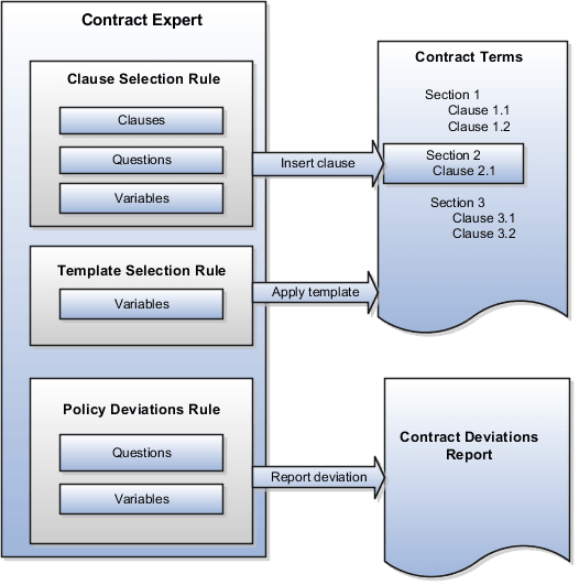

Different Contract Expert rule types support different condition types, as illustrated in the following figure. Clause selection rules, which can default individual clauses and sections into a contract, can be based on clauses, questions, and variables. Template selection rules, which identify the default contract terms template for the contract, can be based on variables only. Policy deviation rules, which identify contract deviations from company policies, use questions and variables only. The following figure illustrates the Clause Selection, Template Selection, and Policy Deviation Contract Expert rules.
Three types of Contract Expert rules.

Clause Selection Rules
Clause selection rules permit you to insert one or more clauses and sections into a contract.

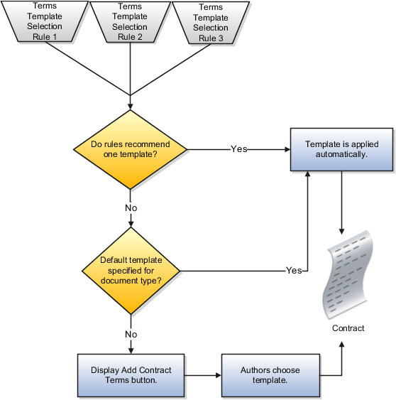

Contract Terms Template Selection Rules
Contract terms template selection rules let you to automatically apply a contract terms template to a contract.
The following table describes the rule properties.
Rule Property
Details
Rule outcomes
The application automatically applies a contract terms template to a contract. Or, if the author removed the contract terms using the Actions menu, the template displays the template name as the default when applying a new template.
When the rule is evaluated
The application evaluates the rule whenever the author navigates to the Contract Terms tab as long as no contract terms template is applied. If a contract terms template is applied to the contract, the template selection rules aren't executed again, even if changes to the contract would result in a different rule outcome.
The rule is also evaluated to determine if the contract contains the recommended template whenever the contract author:
  • Runs the clause deviations report
  • Validates the contract terms or the contract
In both cases, the rule generates a warning if the author applied a different template from that recommended by the rule.
Conditions
Variables only
You can use predefined system variables and those user-defined variables where the values are supplied by a Java procedure.
Where it applies
The rule applies only within the business unit and for the intent specified in the rule.
Contract Expert doesn't apply a contract terms template if the contract terms template default rules you set up recommend multiple terms templates for a single contract. Instead, Contract Expert applies the contract terms template specified as the default for the business document type during contract terms template setup. If no document type default is specified, then the application displays the Add Contract Terms button and permits authors to select a template of their own choice. The choices are restricted to the templates specified for the contract type.The following figure describes choosing a contract terms template for application to a contract.
Choosing a contract terms template for application to a contract.

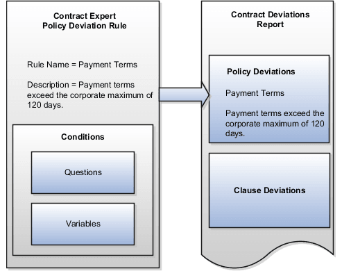

Policy Deviation Rules
Policy deviation rules identify deviations from company policies on the contract deviations report. This report is run by the contract author before submitting a contract for approval.
The following table lists the rule properties.
Rule Property
Details
Rule results
The rule displays a deviation in the contract deviations report.
The rule name becomes the deviation.
The rule is evaluated whenever the user:
  • Runs the contract deviations report
Conditions
Conditions can be based on:
  • Questions
  • Variables
    Both predefined system variables and those user-defined variables where the values are supplied by a Java procedure.
Where it applies
The rule applies only for the contract terms templates within the business unit and for the intent that you specify.
You can build rule conditions out of both questions and variables. In the contract deviation report, your entry in the Rule Name field becomes the deviation name and your entry in the rule Description field becomes the deviation description. The following figure illustrates the policy deviation rule setup.
Contract Expert policy deviations rule.
Policy deviation rules list policy deviations in the contract deviations report, along with any clause deviations that are identified automatically by the application. Contract authors can run the report before submitting the contract for approval and enter comments to explain the deviation to the approver. The report is rerun automatically when the author submits the contract for approval and a copy of the report is attached to the approval notification.
