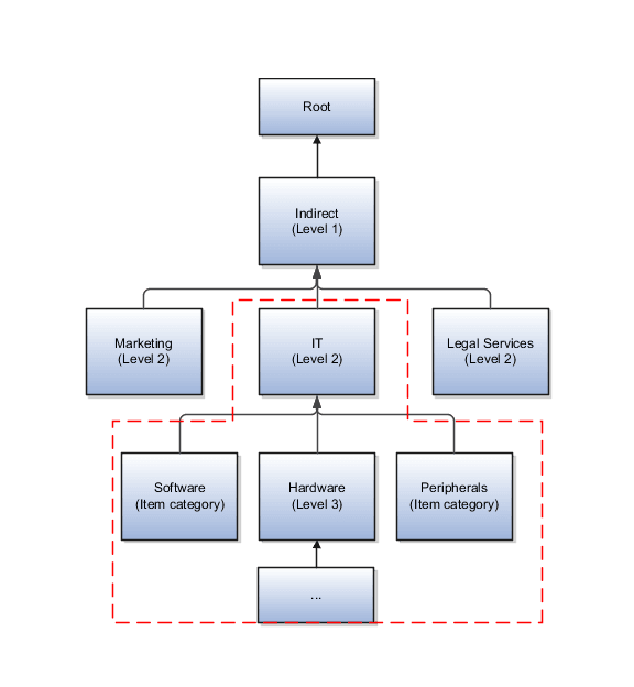

Example Procurement Category Hierarchy
The example procurement category hierarchy has the following levels:
No level number: Root
Level 1, under Root: Indirect spending.
Level 2, under Indirect: Marketing, IT, and Legal Services
Level 3 item categories, under IT: Software, Hardware, and Peripherals
You can create more than 10 levels under the root category of a procurement category hierarchy. You can only set up approvals based on the top 10 levels.
