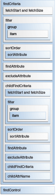

Request Payload Parameters
The parameters of the
find request payload give extensive
control over the search criteria. This figure shows the parameters of the find operation.
This table lists the elements of the request payload and provides a brief description for each element.
