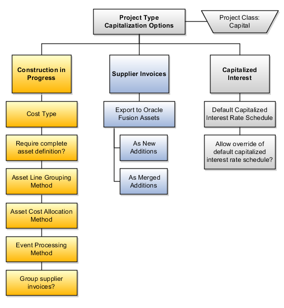

You can assign assets to a project by associating it with a project type that's enabled for capitalization. Enable capitalization for a project type using the Manage Project Types task.
Specify the following information when setting up capitalization options for project types.
Construction in Progress (CIP) Options
Supplier Invoices Export Options
Capitalized Interest Options
Construction in Progress Options
You specify the following Construction in Progress options when setting up capitalization options for project types.

Supplier Invoices Options
You specify the following Supplier Invoices options when setting up capitalization options for project types.
Use this field to specify a default interest rate schedule for capitalized interest.
You can select the Allow Override option to allow an override of the default capitalized interest rate schedule for individual projects.
