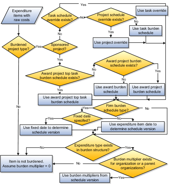

The following graphic shows the decision points and process for calculating burdened costs.
The application selects the expenditure items with raw cost amounts for processing.
The process determines if the related project type of the expenditure item is enabled for burdening.
If the project type is enabled for burdening, then the process determines the burden schedule to be used.
If the project type is not enabled for burdening, then the expenditure item is not burdened. The process assumes the burden multiplier is zero; therefore, burden cost is zero and thus burdened cost equals raw cost.
To determine which burden multiplier to use, the process determines if there is a burden schedule override for the expenditure.
If a burden schedule override exists, then the process uses the task burden schedule override on the associated task. For sponsored projects, the process ignores the task burden schedule overrides.
If no task burden schedule override exists on the associated task, then the process uses the project burden schedule override on the associated project. For sponsored projects, the process ignores the project burden schedule overrides.
If there are no burden schedule overrides, the process uses the burden schedule assigned at the task level for burden cost calculations.
For sponsored projects, the process determines the burden schedule to use for burden cost calculations in the following order:
Burden schedule assigned at the summary task level of the award project
Burden schedule assigned at the award project level
Burden schedule assigned at the award level
If the burden schedule type is a firm schedule, then the process checks if a fixed date is specified for burdening. If yes, it uses the fixed date to determine the schedule version. If a fixed date isn't specified, then the process uses the expenditure item to determine the burden schedule version.
After a schedule version is determined, the process verifies that the expenditure type of the expenditure item is found in any of the cost bases of the selected burden schedule version.
If an expenditure type is excluded from all cost bases in the burden structure, then the expenditure items that use that expenditure type aren't burdened (burden cost equals zero, thus burdened cost equals raw cost).
The process then checks if burden multipliers exist for the organization to which the cost transaction belongs. If burden multipliers aren't defined for the organization, then the process checks if multipliers are defined for any of the parent organizations in the hierarchy. If burden multipliers don't exist for the organization or any of the parent organizations, then the expenditure isn't burdened.
