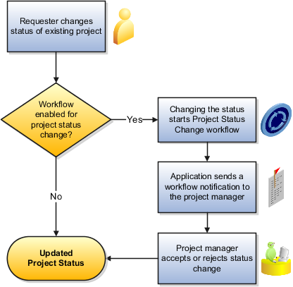

Project Status Change Workflow
When the user sets a project to a workflow-enabled status, the application triggers the Project Status Change Approval workflow. This workflow then notifies configured assignees, who must approve or reject the status change, or seek more information if required. The default approval rules for this workflow route the approval to the primary project manager.
If the approval workflow is withdrawn or results in errors, the application reverts the project to the previous status. Errors can be viewed and rectified by the project application administrator on the Transaction Console page. If the issue persists, log a Service Request (SR) and attach the relevant diagnostic log file.
In the BPM Worklist tool, this workflow is called ProjectStatusNotificationApproval.
Project Status Change Approval Process
Here's a table that describes the Project Status Change Approval process.
| Task No. | Agent | Description | Comments |
| 1 | Requester*  *Project Manager. Project Administrator, or other roles with the privilege to change project statuses.  |
                     Users change the status of a project (through the UI or using REST API) to a workflow-enabled status, which triggers the workflow. | Statuses are enabled for workflow approval by project application administrators in the Manage Project Statuses task within Setup and Maintenance. |
| 2 | The Project Status Change Approval Workflow | The workflow sends notifications to all configured assignees using email or in-app notifications, as configured. | For detailed information on how you can change approval workflow notifications, see Workflow Notifications in the Implementing Common Applications guide. |
| 3 | Workflow Assignees | Assignees review the approval notification and approve or reject the project status change. Assignees may also ask for more information from the requester. |
                         If the workflow uses parallel approvers, then the Voting Percentage rule is used to determine final approval. For detailed information on using BPM Worklist to update approval workflows, see Workflow Approvals and Notifications in the Implementing Common Applications guide. Also see How Invoices Are Approved in the Using Payables Invoice to Pay guide.  |
| 4 | The Project Status Change Approval Workflow | The workflow updates the project status:
 If the new status is also workflow-enabled, another approval task is launched.  |
                     NA |

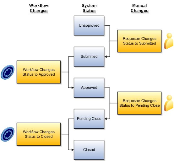

Use the Manage Project Statuses task in Setup and Maintenance to enable or disable project statuses for workflow approval. Select the Enable Workflow checkbox for each project status that should trigger a workflow approval.
For each project status with workflow enabled, you must also specify the following attributes:
Status After Change Accepted: The status the application assigns to the project after accepting a project status change.
Status After Change Rejected: The status the application assigns to the project after rejecting a project status change.
Other rule changes you can make:
- The default approval rules in all the predefined rule sets are configured to send notifications to the primary project manager for approvals. You must review the predefined rules and modify them as required.
You can disable participants that you don’t want to use by enabling the Ignore Participant option or by defining a rule to ignore the participant.
You must have the Projects Application Administrator job role (or another similarly privileged job role) to configure rules for this workflow.
For example, assume that during implementation, you enable workflow for the Submitted status, and configure the following workflow attributes:
In the Status After Change Accepted field for the Submitted project status, you specify the Active status as the status that the application assigns to the project when the status change is accepted.
In the Status After Change Rejected field for the Submitted project status, you specify the Rejected status as the status that the application assigns to the project when the status change is rejected.
In this example, when a requester changes the project status to Submitted, the workflow process routes the status change request to the primary project manager's worklist. If the project manager accepts the status change, the workflow process assigns the Active status to the project. If the project manager rejects the status change, the workflow process assigns the Rejected status to the project.
