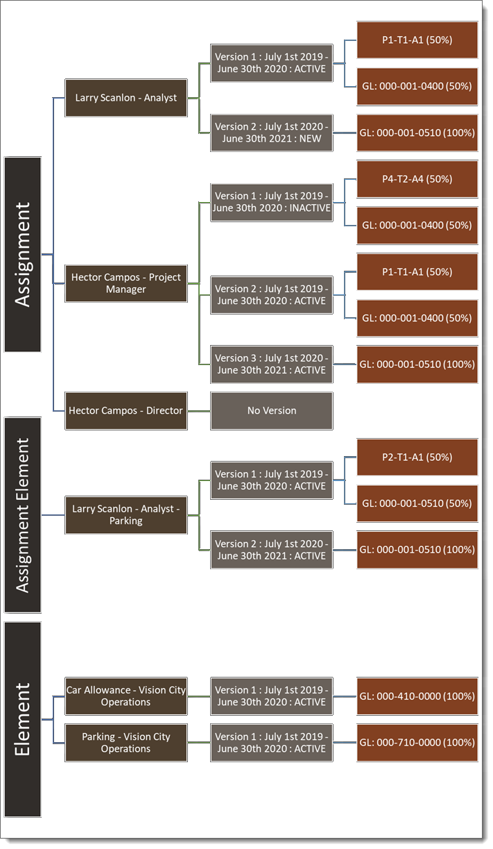

Labor Schedule Components, Types, and Distribution: Example
Here's an example that illustrates how you can use labor schedule components to create labor schedules, how you can create labor schedules of various types, and how these will be distributed when run.
Larry Scanlon, an analyst in Vision City Operations, has the following personalized labor schedules:
| Labor Schedule Type | Labor Schedule Header | Labor Schedule Version | Distribution Rules |
| Assignment | Larry Scanlon - Analyst | Version 1: July 1st 2019 - June 30th 2020, ACTIVE | P1-T1-A1 (50%) |
| GL: 000-001-0400 (50%) | |||
| Version 2 : July 1st 2020 - June 30th 2021 : NEW | GL: 000-001-0510 (100%) | ||
| Assignment Element | Larry Scanlon - Analyst - Parking | Version 1 : July 1st 2019 - June 30th 2020 : ACTIVE | P2-T1-A1 (50%) |
| GL: 000-001-0510 (50%) | |||
| Version 2 : July 1st 2020 - June 30th 2021 : ACTIVE | GL: 000-001-0510 (100%) |
Hector Campos, a director in Vision City Operations, has the following personalized labor schedules:
| Assignment | Hector Campos - Project Manager | Version 1 : July 1st 2019 - June 30th 2020 : INACTIVE | P4-T2-A4 (50%) |
| Version 2 : July 1st 2019 - June 30th 2020 : ACTIVE | P1-T1-A1 (50%) | ||
| Version 3 : July 1st 2020 - June 30th 2021 : ACTIVE | GL: 000-001-0510 (100%) | ||
| Hector Campos - Director | No Version |
Additionally, Vision City Operations offers two pay element components to all their employees' salaries, administered through the following labor schedule:
| Element | Car Allowance - Vision City Operations | Version 1 : July 1st 2019 - June 30th 2020 : ACTIVE | GL: 000-410-0000 (100%) |
| Parking - Vision City Operations | Version 1 : July 1st 2019 - June 30th 2020 : ACTIVE | GL: 000-710-0000 (100%) |
Putting them together, we have the following labor schedules for these two employees:
