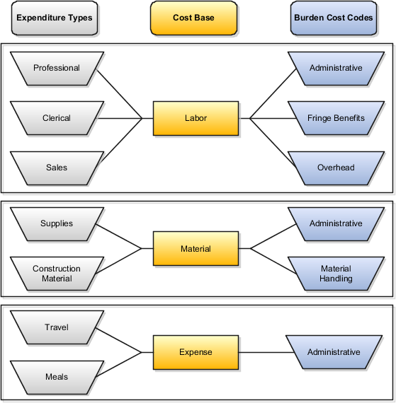

You define the project cost buildup using a burden structure. A burden structure determines how you group expenditure types into burden cost bases and establishes the method of applying burden costs to raw costs.
Before creating burden structures you must define expenditure types, cost bases, and burden cost codes, which are the main components of a burden structure.
      The diagram illustrates a burden structure with the following cost bases.
Labor
Includes the expenditure types Professional, Clerical, and Sales.
Is assigned the burden cost codes Administrative, Fringe Benefits, Overhead.
Material
Includes the expenditure types Supplies and Construction Material.
Is assigned the burden cost codes Administrative and Material Handling.
Expense
Includes the expenditure types Travel and Meals.
Is assigned the burden cost code Administrative.
