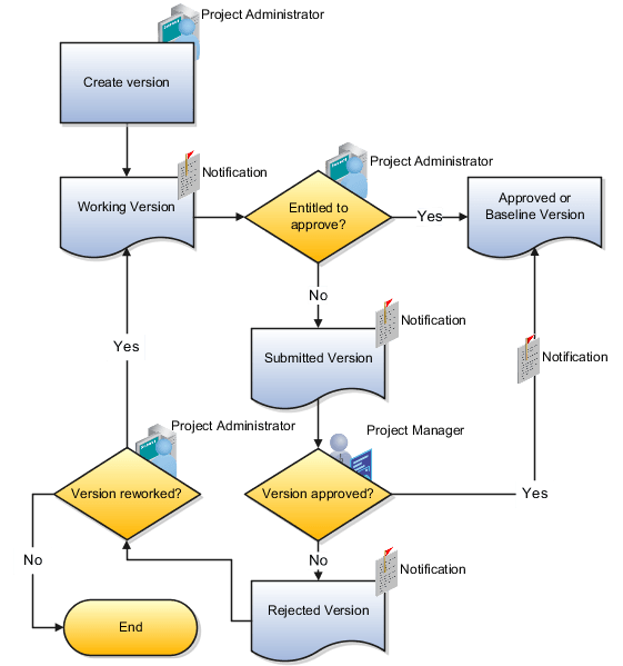

The submitted budget or forecast versions undergo a single level of approval. However, during implementation, you can define approval rules based on the following parameters:
Total raw cost
Total burdened cost
Labor effort
Equipment effort
Margin percentage
Margin
For example, set rules such as:
If total burdened cost is less than or equal to $50,000, then the project administrator can approve budget versions.
If total burdened cost is greater than $50,000, then the project manager must approve budget versions.
By default, the project manager can approve the budget or forecast versions. Additionally, a project administrator can configure which participants can approve the budget or forecast versions, depending on the business requirements.

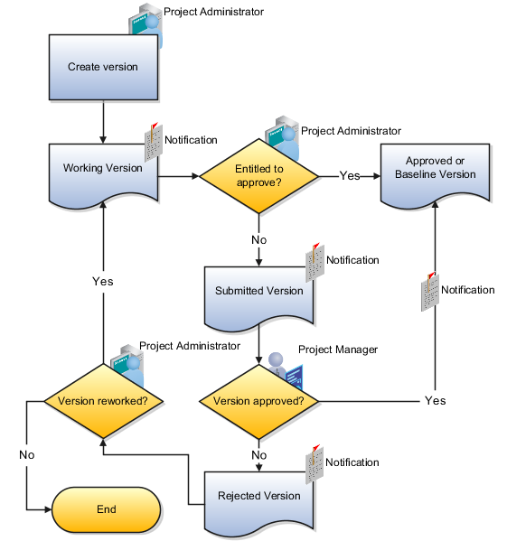

Understanding the Budget and Forecast Status Flow
The following table and figure describe the stages in the budget and forecast status flow.
Action Performed |
Status |
Notification Sent To |
Action Required |
Create version |
Working |
Creator (requester) |
None. |
Submit version |
Submitted |
Requester, approver, project roles, and participants |
Approver can approve or reject version. |
Approve version |
Approved or Baseline |
None. |
Reject version |
Rejected |
None. Requester can optionally rework version. |
Rework version |
Working |
None. |
