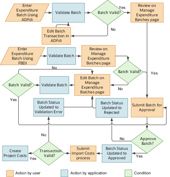

Here's a graphic that illustrates how cost transactions can be imported, reviewed, and approved in Costing.
Here are the high-level tasks associated with cost transaction import, review and approval.
Create new project cost transactions for approval-enabled transaction source documents using either ADFdi or FBDI.
The application validates and creates the imported transactions.
For batches that you create using the FBDI flow, the application validates the transactions and creates them in the application, regardless of validation failures. You can review all imported transactions (with appropriate statuses) on the Manage Expenditure Batches page.
For batches that you create using the ADFdi flow, the application validates the transactions, and if even one transaction fails validation, it rejects the entire batch. You must correct the errors and retry exporting the batches.
Update the transactions as required and submit them for approval.
If the transactions are valid, you can submit the batch for approval.
If the transactions aren't valid, then you must edit them. The application validates transactions every time you save them, one at a time. If they are valid, then you can submit the batch for approval.
The application runs the Project Expenditure Batch Approval workflow on the rules.
If the batch is approved, then the application updates the status of the batch to Approved.
If the batch is rejected, then the status of the batch is updated to Rejected, and you can edit the batch as well as its transactions. After reediting the transactions, you can resubmit the batch for approval.
Once the batch is approved, run the Import Costs process to pick up the transactions and convert them to project costs.
As part of the Import Costs process, the application validates the transactions again. If the transactions are valid, they are converted to project costs, and appear on the Manage Project Costs page.
If transactions fail validation during the Import Costs process, then the status of the batch is updated to Validation Error, and you can edit the batch and its transactions by drilling down from the Manage Expenditure Batches page.
Update the transactions that have validation errors and resubmit the batch for approval. Once the batch is approved, the application runs them through the Import Costs process to convert them to project costs.
