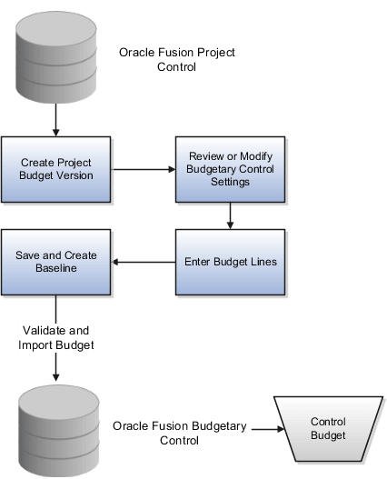

- Create a baseline. You can create a baseline from the Manage Budget Versions page,
Edit Budget Version page, or the Review and Finalize Budget page.
The application creates separate control budgets for the project, resources, tasks, and funding source in Budgetary Control. The number of control budgets is based on a combination of attributes, such as project, task, resource, award, and funding source.

- Once the budget is set to baseline status, any applicable charges for the project are subjected to budgetary control validation. All applicable control budgets are validated for both the raw costs and the burden costs, if applicable. The View Funds Results dialog box shows the budgetary control validation results. For sponsored projects, the Award Overview page provides the available funds details for all the control budgets.
- When the Integrate Project Budget with Oracle Fusion Budgetary Control scheduled process is triggered, budgetary control automatically imports the budget version during the baseline process. The application validates the budget and checks for exceptions. If the budget version doesn't have any exceptions, the budget import is successful, and a control budget is created. If there are exceptions, check the status of the Integrate Project Budget with Oracle Fusion Budgetary Control process, review the errors, and take appropriate action.
